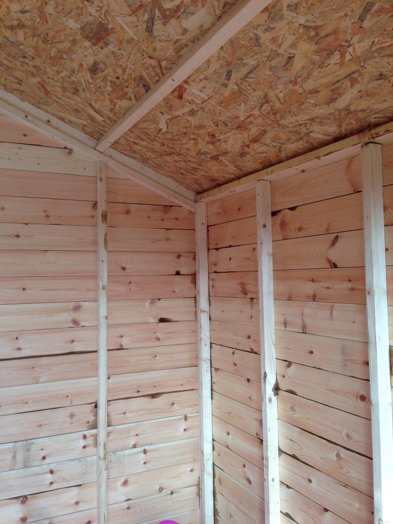

Hi all, looking for some advice about insulating my kid's summerhouse.
Not long had it put in and have recently acquired some 40mm Kingspan, which I'm planning on using for the walls (and roof if theres enough leftover).
The batons are exactly 40mm deep so I can nicely fit these boards in but there will be no air gap. Is this going to be a massive problem? It's only 7x7 and there is an opening window. I will be boarding over the insulation with ply, (not sure of size yet) For the floor I have some old underlay & carpet to use.
Does anyone have any suggestions on what to do regarding the insulation?
thanks all
Why exactly are you thinking of insulating it and what do you want to achieve from doing so?
