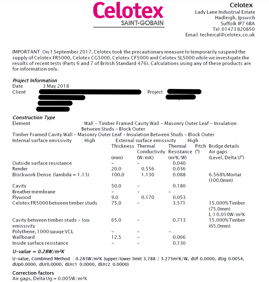

Please please advise. Our architect has listed 150ml insulation to go into our timber frame extension. This means the space is reduced. I spoke with building regs who say it does not matter what size as lobg as it is a U value of 0.21. We have spoken with celotex who unbelievably could not tell us which product was needed. Naturally we would prefer the cheapest and narrowest option. Can anyone help.

Use the free Celotex calculator online, Celotex can't tell you over the phone as there are other factors involved.
In anycase whoever you spoke to at Building Control was wrong, the U Value required for a new domestic extension wall is 0.28 not 0.21 (which is worse ie needs less insulation).
The last timber frame extension I drew up had 80mm Celotex between the studs and that achieved 0.28.
I think in England you generally have to have a 140mm frame to meet these U values, so you may be stuck with that sort of dimension anyway.

It allowed for 140mm studs, insulation only between the studs so a 65mm void for services as in fact I could have got away with 75mm.
