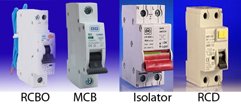

It does not really need to be so low if there is an RCD or RCBO PartID_CU.jpg.
The meter used to test insulation resistance uses 500 volt DC, and it is unlikely to show 2Ω it would show 2MΩ, but the only thing it shows is
and to do that the circuit would need disconnecting at the consumer unit, as an MCB only switched the line, not the neutral, and the neutral is linked to earth, the whole home could be tested by turning off the Isolator, or part of home if there is an RCD, but to test just one circuit some RCBOs are double pole, but in the main it would need to open the consumer unit, and disconnect inside the unit to test.

Residual Current Device which you expect to find in your Consumer Unit (CU) (aka Fuse Box). The usual advice is to post a picture of the CU so that we can see all the "switches" and their labels.
