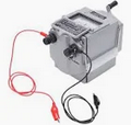

I remember the old tester
I would get the apprentice, he was not daft enough to hold the leads, but I knew to grip them hard, and it would not build up voltage, so I would hold them first, then get him to hold them onto the item to be tested, then wind the handle. Same tricks done with an impulse mag.
However, when capacitor discharge ignition systems came in, my friend ending up in hospital, and we stopped doing stupid tricks, OK some healthy person may be OK, but how does one know if someone has a dicky hart, by the time you find out, it's too late.
These testers can kill, and not nice to get an electric shock anyway, I know on Sizewell two of us sent to same job, but neither know the other was also on the same job, and yes one got a shock when other guy using an insulation tester, and the guy with tester was getting odd results, foreman lucky for him was a good runner.
Do make sure there is someone with you, just in case, and be very careful.
What stopped me playing was when I thought I had killed a guy, I had spotted the wires, and know someone would try and give me a shock, when he came up, as he went to turn the leaver, I put my fingers on his neck, OK he was trying to get me, but he fell to the floor, and seemed not to move for a good few minutes, I was intending to teach him a lesson, it was me who got the lesson. OK I was only 18 at the time, now 73, but not forgotten it.
Be very very careful.
