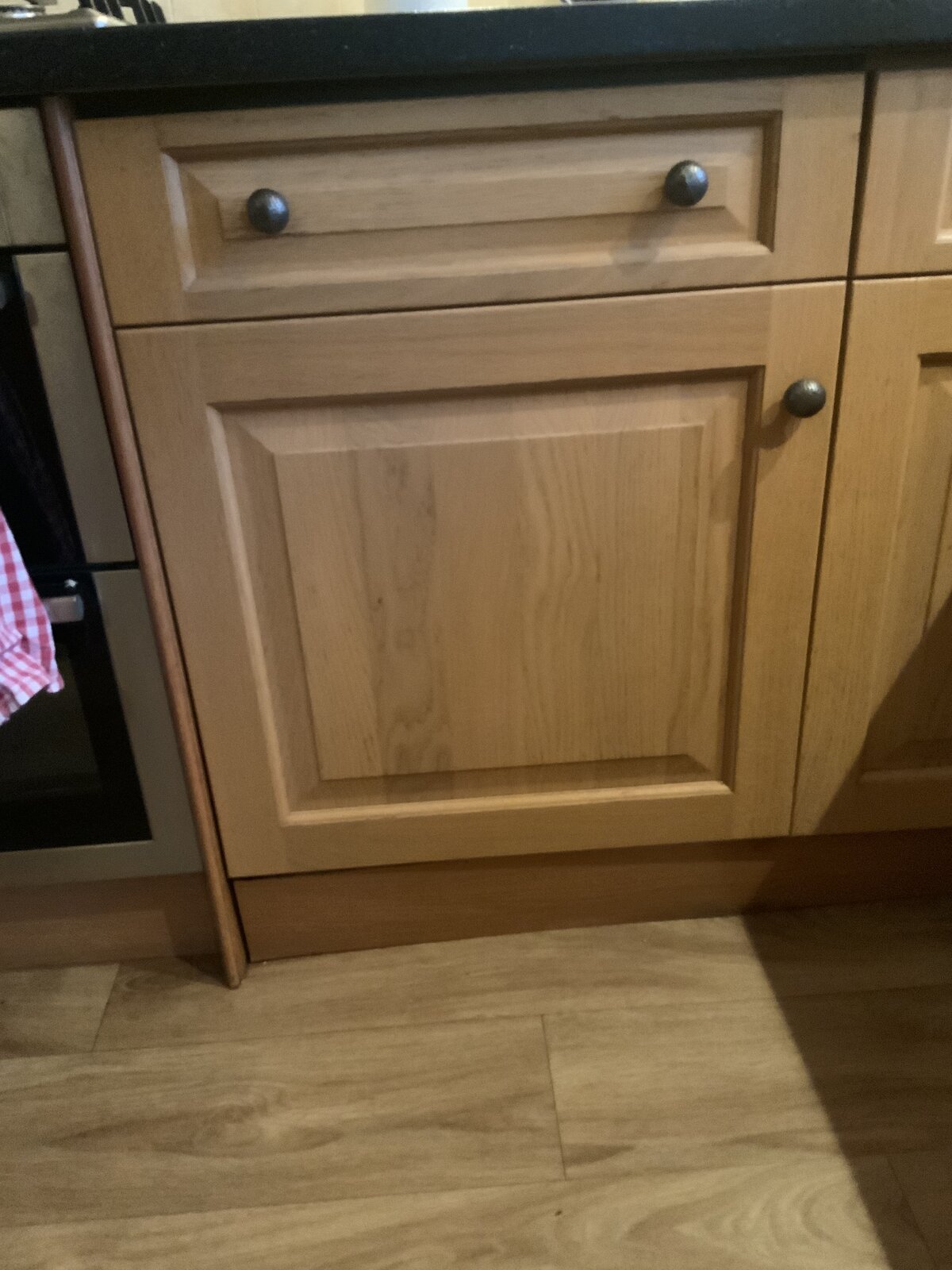

Our Hotpoint dishwasher has packed up - not enough pressure going into the arms to turn them so I suspect the pumps knackered so it's time for replacement. We've had 21 years of daily use from it so not too bad. My question is, it has a front on it that matches our kitchen and I'm just wondering if they are universal fitment - have things changed in recent years? I fitted the original front myself but I can't remember how after 21 years! I don't want to get another integrated machine if our original front won't fit it. Surely it must though, shouldn't it? Its just a standard full size front door - are they a standard height? Can anyone shed any light on this?

ATTACH]249198[/ATTACH]

If you get a new one, the same door will fit.
In some instances the plinth may need to be trimmed along the top edge to allow the door to open - depends on the particular dishwasher and exactly where the hinge is.
The measurements that matter are the width of the dishwasher, most are designed to fit in a 600mm width but some are narrower
and the depth - particularly if there are pipes/cables/other at the back of the space.
Height mostly unimportant unless your worktops are installed unusually low.
Reviews should generally be ignored - always heavily biased towards people who had problems of some kind, most of which were avoidable.
The review about the door being 1cm too tall is nonsense.
