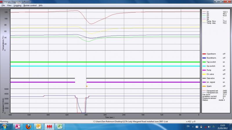

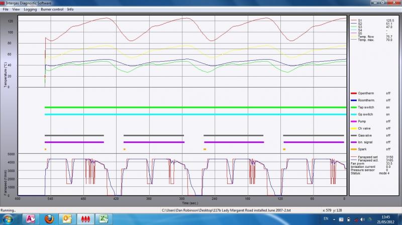

Will post up some charts that help explain the diagnosis in a while.
Boiler in good condition :
Heavily scaled:
When S1 reaches between 120 & 125, it modulates down, or moves to status 1. Limescale prevents the efficient heat transfer to hot water.
Heavily scaled:
Heavily scaled:

Heavily scaled:
After having good look at this chart it does look a bit like that. I have recorded video (not sure I can post it here) which shows that it goes from 6 to 3 to 1 and then back 3, 4 and 6..
It completes that cycle within roughly 2:30 - 3:00 minutes. Stays for a minute or so in 6 and then does that same cycle again....
