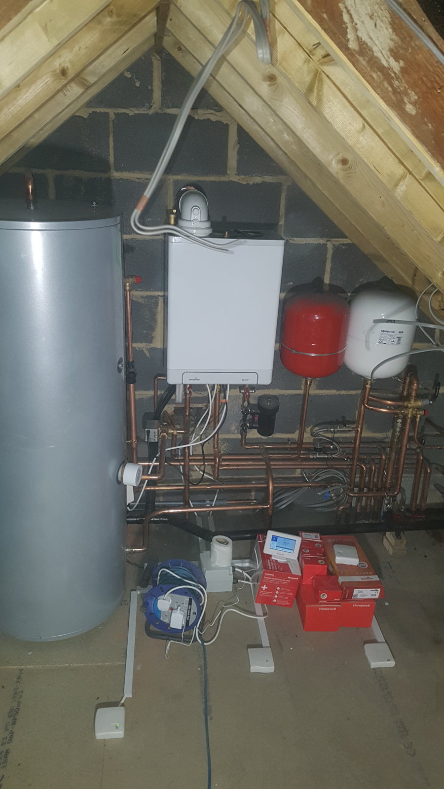

Hi, guys.
Based on previous advice on here, i now have an Intergas Eco RF 24 and 200L Joule Cyclone UVC. They will be wired in an S-Plan plus configuration as per attached diagram.
My first question is whether i also need an external programmer/timer clock for the UVC?
Secondly, @Dan Robinson and @muggles said to set it up on HW priority; what does that mean exactly and how would it work assuming the UVC is running on an external timer?
Edit: Forgot to mention i will also use a Heatmiser UH8 wiring centre (if that makes a difference).

The picture above is all the plumbing I did on the job. Someone else did the heating and bathroom plumbing. I liaised with the I other guy who ran the necessary pipes up to an agreed location.
As Dan says, there no reason whatsoever why it can't work with your system, you just need someone who understands wiring. It's actually quite simple

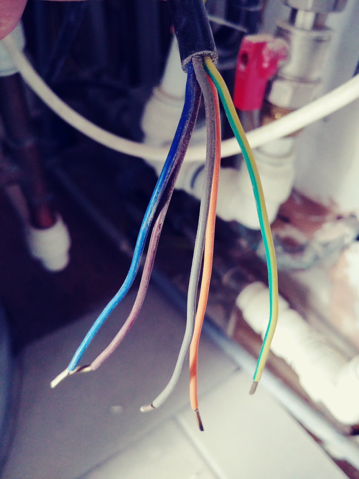

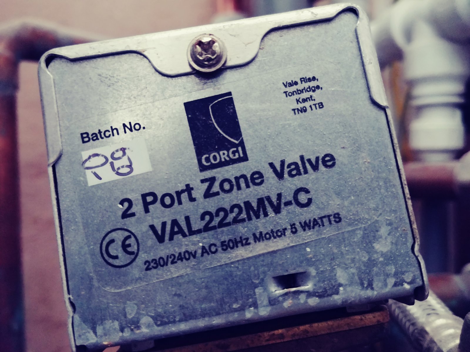

Would you guys mind telling me what should be added to my splan system to make HW priority work? As it stands i will have the heatmiser uh8 operating the 2x heating valves, manifold pump and 5 ufh zones. the dhw cylinder (2 port) valve will be operated by a separate relay. the relay is part of a wireless automation system that will act as the timer clock.
Is the cylinder 2 port a 5 or 6 wire one?
If 5, is it a honeywell?
If yes change the head, use the white wire to link to the heating grey wires instead of the regular permanent live.
It's a Corgi five wire. See pics attached. None of the valves have been wired up yet; electrician is coming on Monday for that.

What is the extra (white) wire for?
Also., from reading another thread on here, it looks likes it's not that easy to find 22mm two-port valves with six wires.
