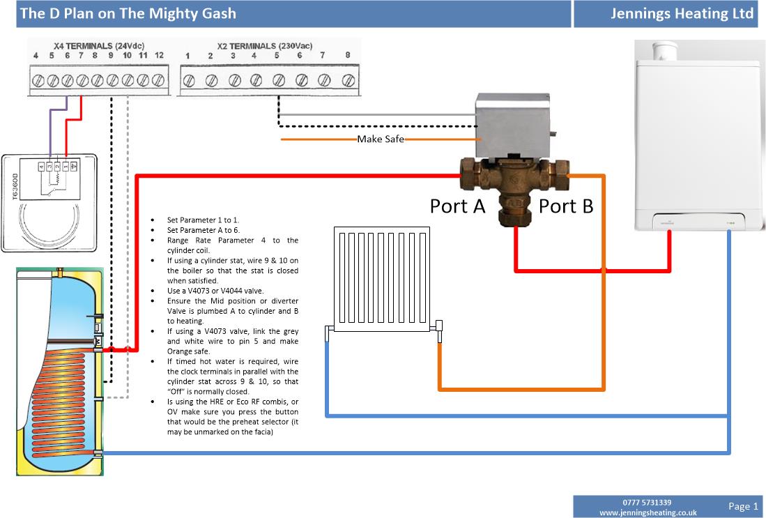

Thanks for the image, confirms the wiring to the boiler, im using Splan + at the moment so may have to go with the diagram from kim.
Any chance you have come across or know of a method to where i can use room stat on x2 terminals (so keep the existing zone valve wiring for CH) and hot water from x4 side? - ie use 230v for room stat and 24v for hw side?
Im thinking that i can just disconnect the hot water zone valve and connect CH back as is, and then use the relay method to open hw zone and kick the boiler in?

Only multi zoning - it works fine if you don't want variable flow temps. Weather comp is better for this.
Your installer should be able to work out how to adapt it - i can think of a couple of ways now, btu I'm sitting on a plane at the moment so you 'll have to use your imagination.
no worries, just need 5 min in the day to put pen to paper and figure it out ;) enjoy your time away!
