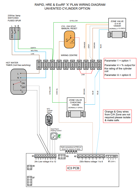

I've spoken with tech support and my local Intergas expert. Neither were 100% sure whether you could do the PDHW X-Plan with two zones. Tech support found a diagram which they thought might do it but it was marked strictly for internal use only.
I understand the general idea where the boiler sends a signal to the HW zone valve which then sends a signal to close the NO CH valve. What I can't see on the wiring diagram is what would control the two other valves which operate the two heating zones.
The official Intergas X-Plan wiring diagrams all seem to show it using OpenTherm. But I think I've just read something from the top Intergas technical bod which says you can use the switched live instead. That would make X-Plan with two zones easy, I think. But it would be nice to know whether it can also be done when using OT. That would be the best scenario.
I thought it might be useful to show the diagram I am looking at which covers the HRE boilers. It's just so different to what I am used to.

I've read that link. It's fantastic. Is it the case that most OpenTherm capable thermostats will only send one signal. Either on the OT connection or on the SL? But EPH controls can send a signal on both. Which is why they can be used to control a zone valve whilst also using OT?
Just found this MNW67 - I know its a couple of years ago but what did you do in the end? Which controller? Do you know if the nest will send signals on both OT and SL ?
