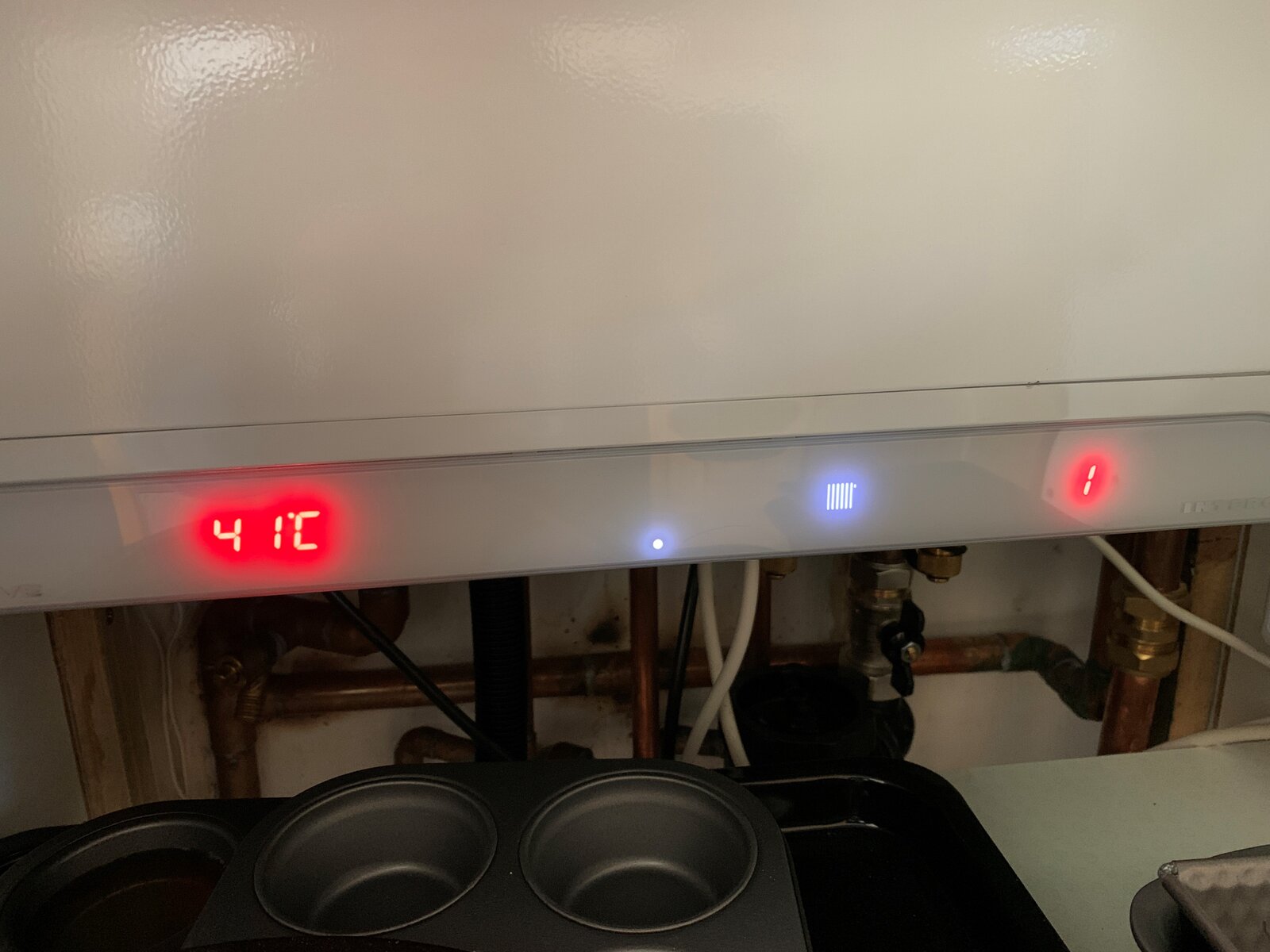

Since I discovered I can turn the display of the boiler on so it shows what it's up to all the time, I've noticed that now we are moving back into cooler days and it's being used on the odd occasion, it shows a status of 1 quite a lot.
In the attached image you can see the set temp is down to 41 thanks to weather comp, and the burner is off with status 1 showing. It appears to cycle to this more often than I think is ideal.
Any ideas what this means, and more importantly if it is a problem or not?

It's bound to cycle more with a low setpoint on a high output boiler. What's the pump overrun period set to?

The installer is supposed to set the parameters for your individual installation , the default is factory set, if you have a small heating demand , setting the parameters properly will solve your problem

What sort of thermostat do you have, is it opentherm ? Our evohome works well and the boiler modulates down to about 4kw ish
I’ve got mine at home set up and we have a lot of radiators on 4 floors. I’ve set it to 50% heating load which is about 18kw. Still might be slightly too high
They come set at 70% which as Ian suggests can be quite high and will cause it to cycle

As it stands, it is indeed set at default 70% output.

The problem is not the boiler output it's the WC dragging the flow temp down. If you set the flow to 70 degrees the radiators will only become that hot if the outside temp is lower than minus 9 degrees. Anything warmer than that and the calculated flow temp will start to drop.
If it's around 16 degrees outside at the moment the flow temp with a 70 degree setting will indeed be around 40 degrees. It's all in the manual if your installer bothers to read it.
Condensing boilers are designed to run at lower flow temps but if it spends most of it's time around that output you will get excessive erosion of the fins in the heat exchanger, I've seen them very heavily worn at 4 years old where 10 year old ones run at 80 degrees are fine.
You will find that the property will take forever to get up to temp from cold and if your heat loss is that bad you'll be lucky to get it warm enough internally.
My advice is for you to get the boiler properly serviced and set up but then to change over to an Opentherm compatible thermostat and ditch the WC.
OT will run the boiler at the heating setpoint, (say 65 degrees) until it gets within 1 1/2 degrees or so of your thermostat setting then it will settle down to cruise control. You get a much faster initial warmup followed by efficient heating.

Depends on the boiler but most either ignore WC or just use it as a reference input when running OT.
IG pretty much ignores it all together
It’s a hre 36/30. I thought WC must be being overlooked.

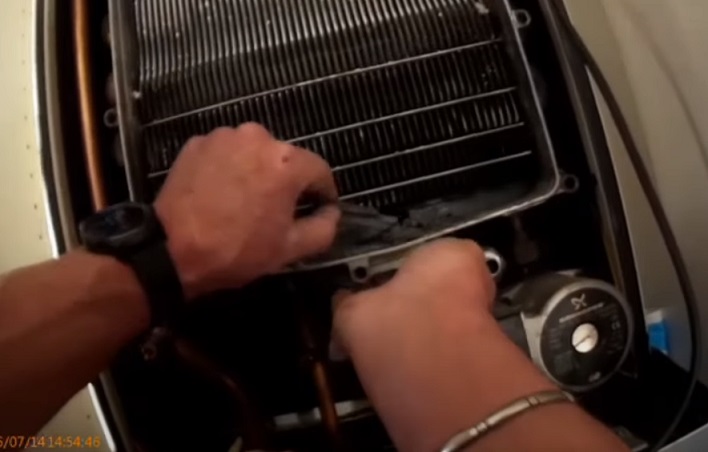

It isn't known how old this boiler is but the corrosion of the aluminium heat exchanger appears to have created debris.
If boilers are cooling their combustion products below the dew point while they are still in contact with aluminium then significant corrosion / erosion of the aluminium is un-avoidable.
Cast iron is also corroded where as good quality stainless steel is not significantly corroded.
