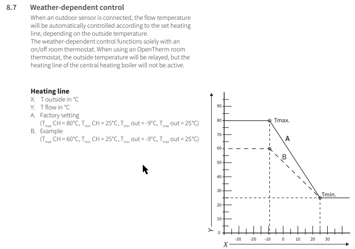

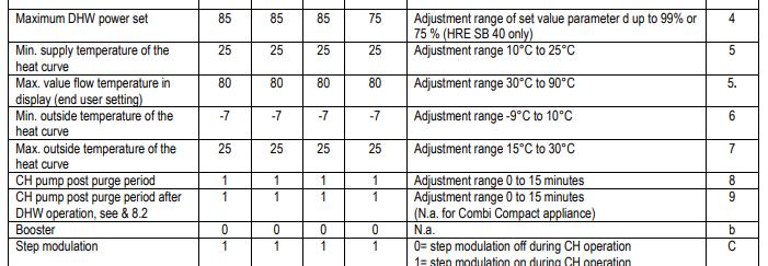

Been doing a bit more digging and I can see much more clarity in the manual for the HRE. It lists a range of parameters relating to weather comp:

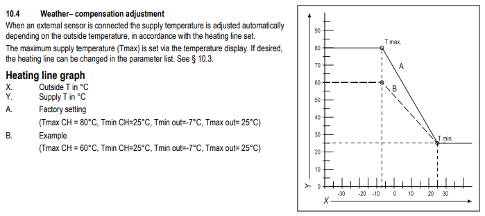

It's also interesting to compare the MI for the HRE and Xclusive range, as one clearly includes documentation around the weather comp parameters, whilst the other doesn't:
HRE:
Xclusive:
Anyone who knows Intergas - can you confirm if the Xclusive range does include the ability to edit the heat line parameters?

Not an Intergas expert by any means but I think the answer is in the second illustration isn't it? The factory settings differ from the example B so it must be adjustable. Unless you want to alter the line in some other way but that's usually found on the better small commercial and up boilers.
Agreed - that's my thinking too. The Xclusive MI certainly seems to suggest they can be adjusted, just doesn't actually explain how or which parameters!
