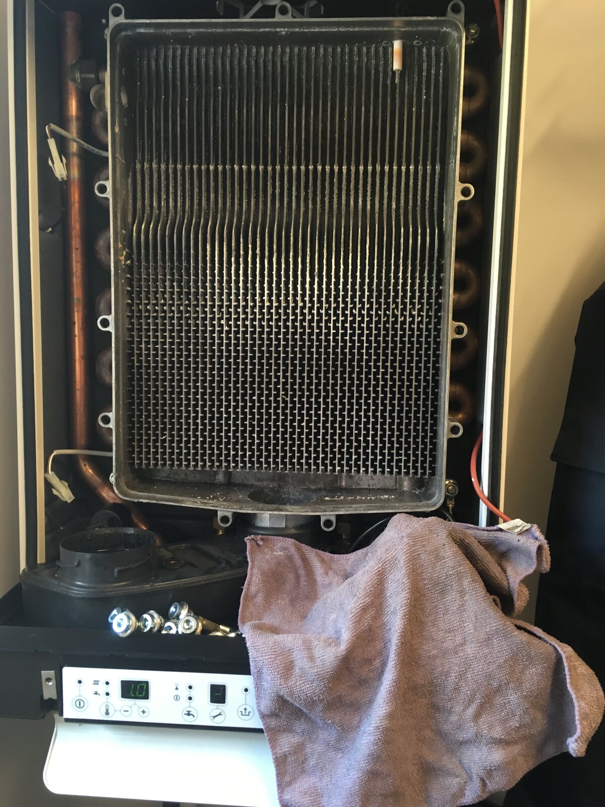

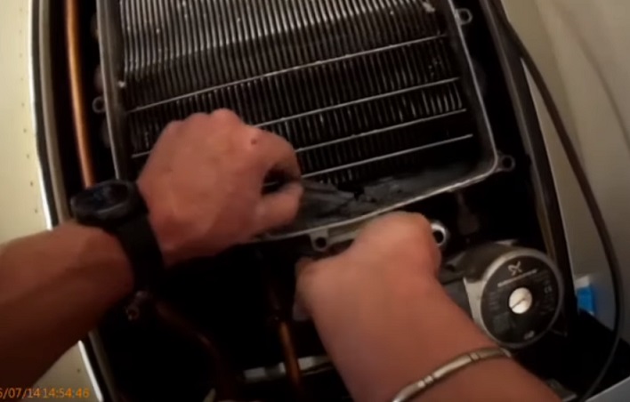

It isn't known how old this boiler is but the corrosion of the aluminium heat exchanger appears to have created debris.
If boilers are cooling their combustion products below the dew point while they are still in contact with aluminium then significant corrosion / erosion of the aluminium is un-avoidable.
Cast iron is also corroded where as good quality stainless steel is not significantly corroded.

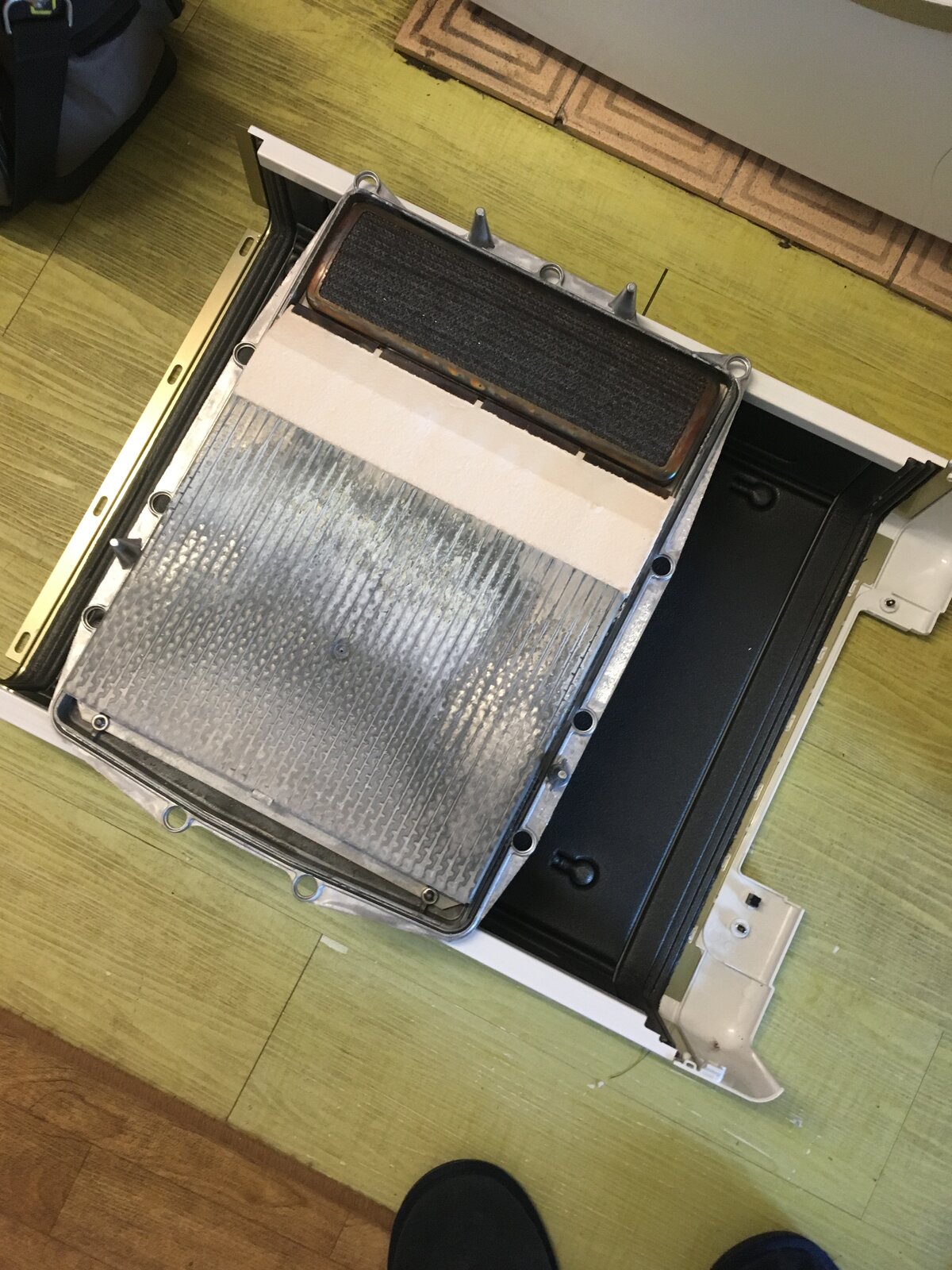

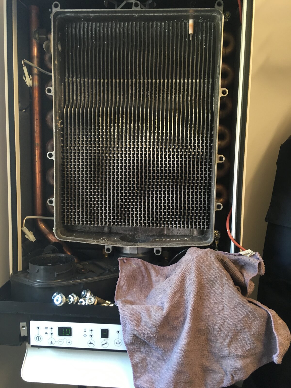

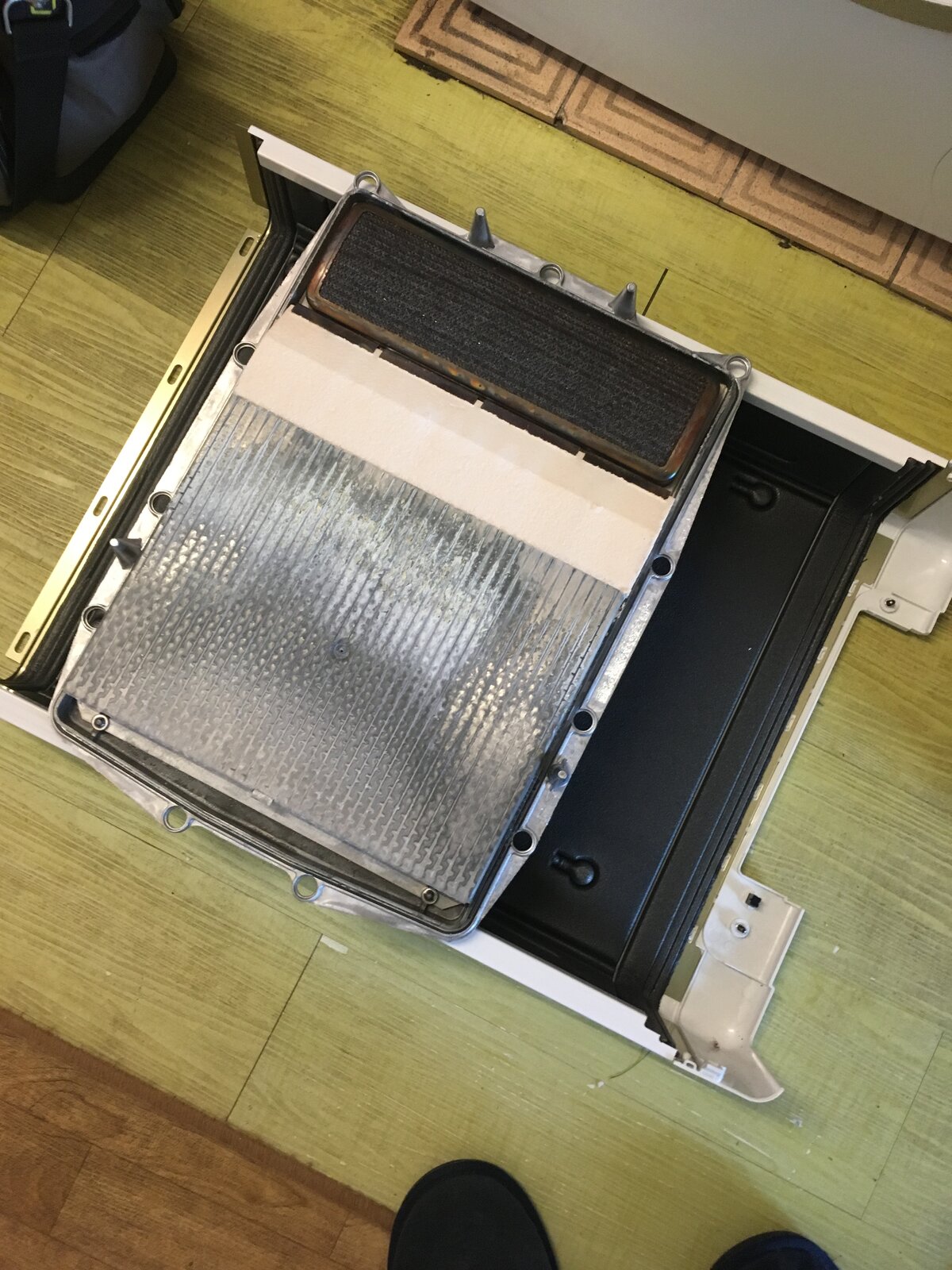

This is the inside of my Eco RF30 at 12 months old, connected using OT and normally runs between 55 and 40 degrees.
