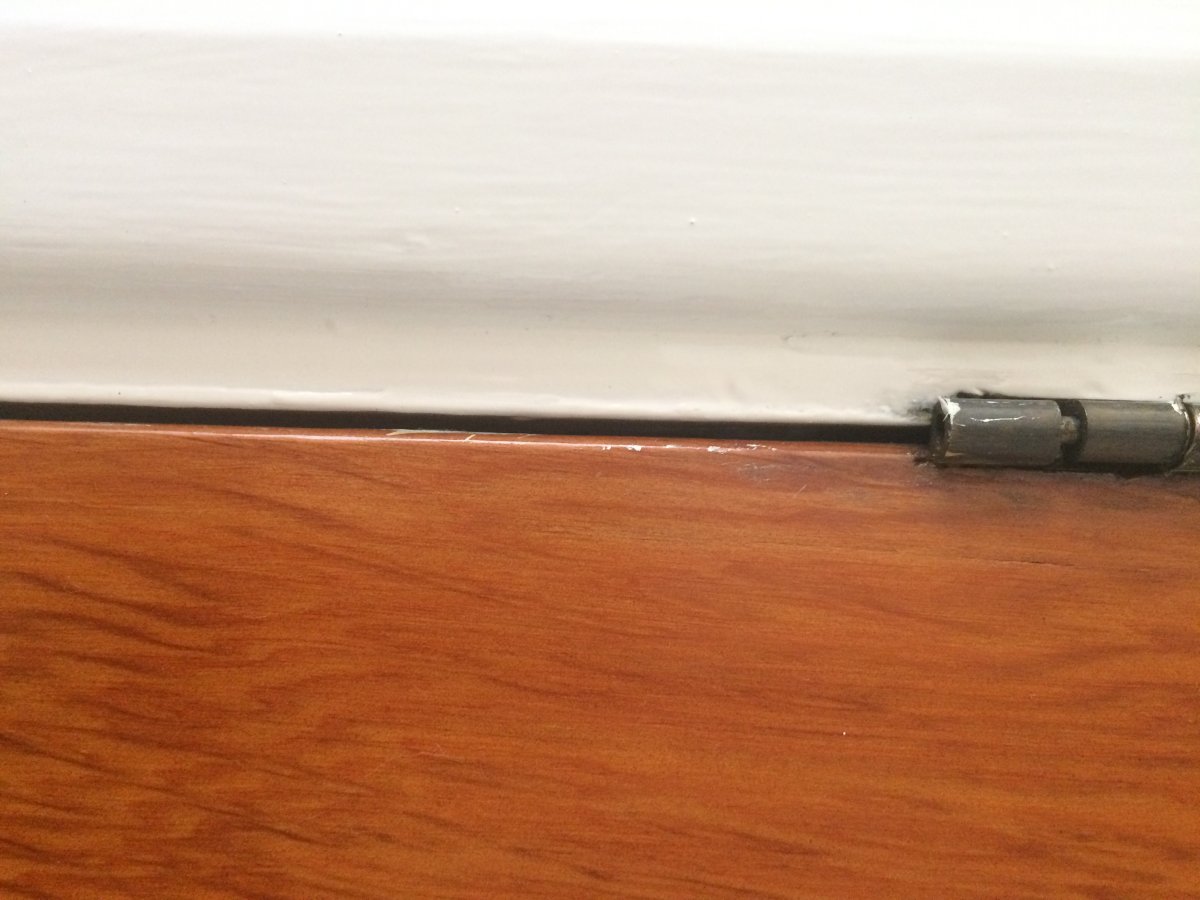

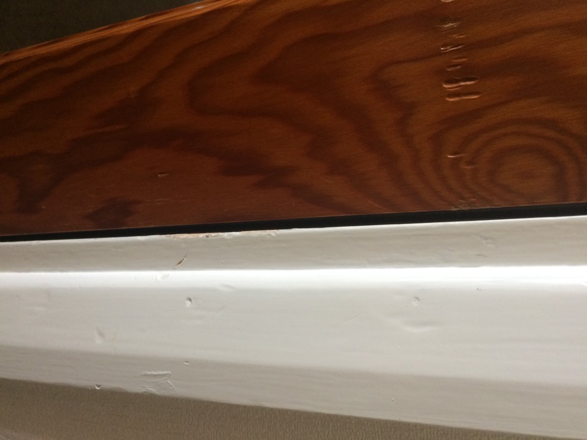

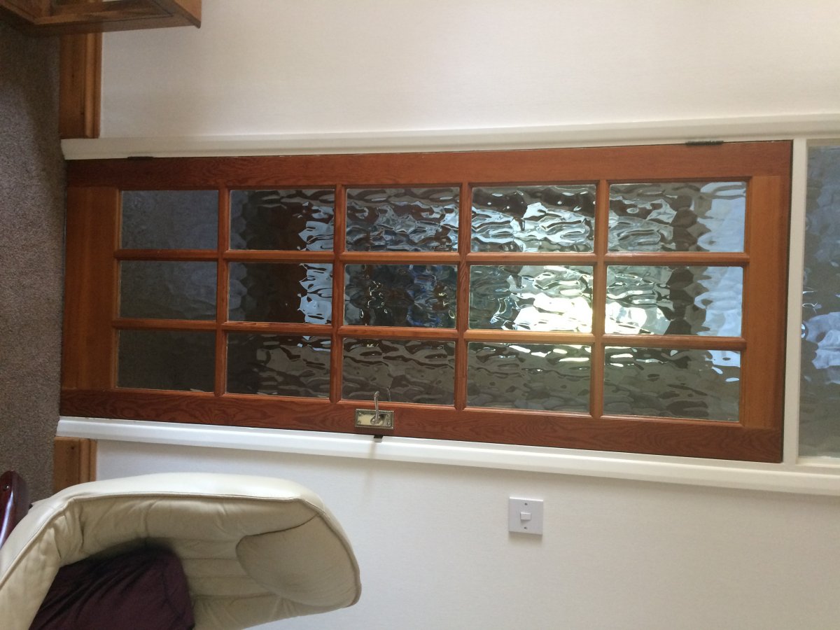

See pics attached:
1 -Door open.JPG 2_Door closed.JPG 3 -Gap-top hinge.JPG 4_Gap-bottom hinge.JPG 5_Gap-top latch.JPG 6_Gap-lower latch.JPG

Normally, a door that is not hung straight, will fall towards the direction that has a natural lean, so at the point that it swings to a stop, it should be leaning over, and so out at the top. If the door is vertical in every direction, ie, side to side, and front to back, then it should open, and stay in the position that you left it. So if the door is vertical in every direction, then it has to suggest a hinge issue.

(Although from your photos it looks to me like the top hinge sticks out from the frame more than the bottom one which is cut right into the frame...)
You're right Gerry. The top hinge is about 1/32" proud of the frame and the lower one flush. Difficult to correct this as c'sunk screws will self-centre but may try a bit of 'persuasion'.
