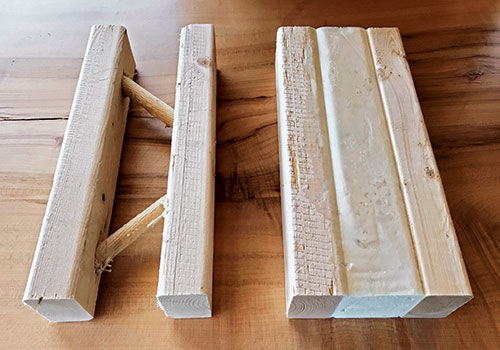

'Thermally broken' studs seem to be a thing in the US (although they are whole wall thickness):
I have heard mention (probably from this forum!), of cork insulated structural studs - but I haven't found them anywhere.
It seems odd, that as so much of the UK's housing stock could benefit from extra insulation, such things as 'insulated structural studs' aren't available on the DIY market. Is this an idea for Dragons Den? ;)
