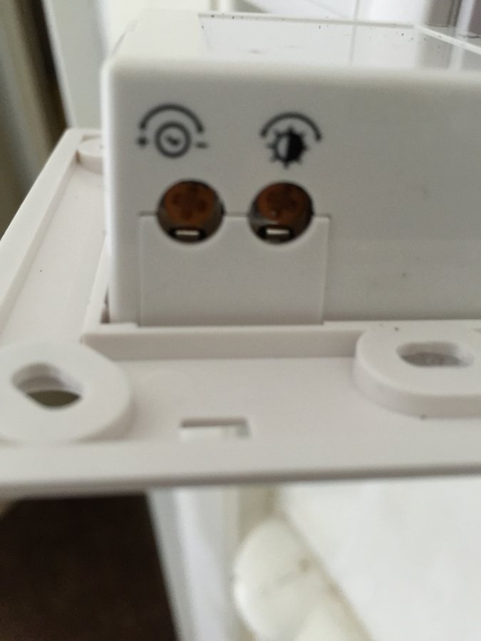

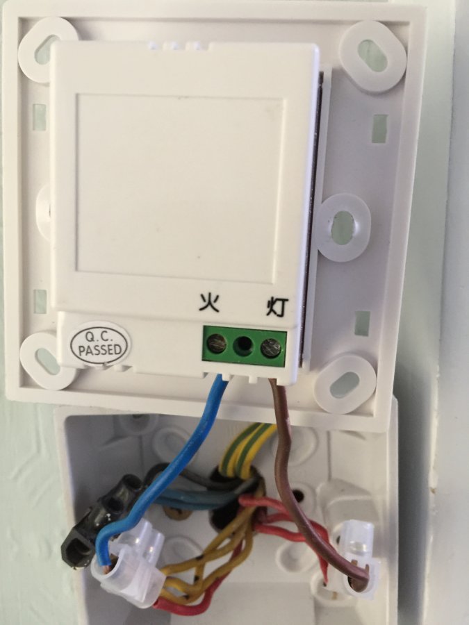

I have attached a couple of pics of two of the switches and one showing the adjustment for timer and light level.

It looks as though you have neutrals present at each switch location, in which case it would be easy to install motion sensors with a 3-wire connection (live, switched live, neutral) and suitable for parallel connection. Again, I would suggest you verify the current sensors individually by disconnecting the others and checking each one in turn. If they all work fine then, it's a problem with the sensor design not permitting parallel operation.
