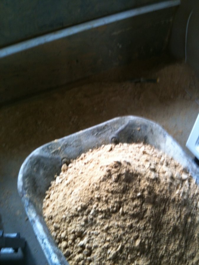

I have been rendering my new block work walls with render and one of my walls that i did 2 days ago has not set.
All the others are fine and have set hard but this one, the mix 5:1 sharp sand to white cement is still soft. rub it with your finger and it is moist and crumbles away. The cement that fell and dried just crumbles like dried sand.
I did notice that this batch when i mixed it was sticky and when i applied it to the wall it kept sticking to the metal tool, and also the cement mixer walls (not usual)

Could it be that i grey rendered 5 days ago over old block work and that it hasnt dried out enough yet?
Ok getting a little bit confusing it's still wet but crumbly? I thought you said it was dry and crumbles like dry sand? It was 5 days ago like in last post or 2 like in earlier post? You also contradict yourself again by saying new walls now it's old walls

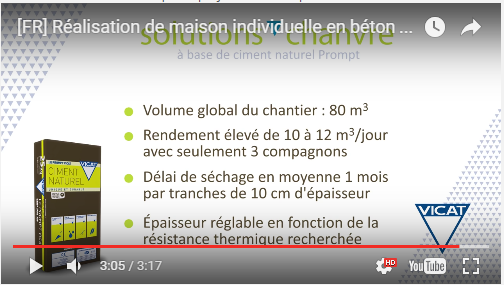

Also found this:
http://www.cimentetarchitecture.com...a-technique-de-projection-de-beton-de-chanvre
The important bit translated (Delai de sechage, etc)
Drying time on average 1 month per 10 cm thick
This was for render with some sort of hemp binder.

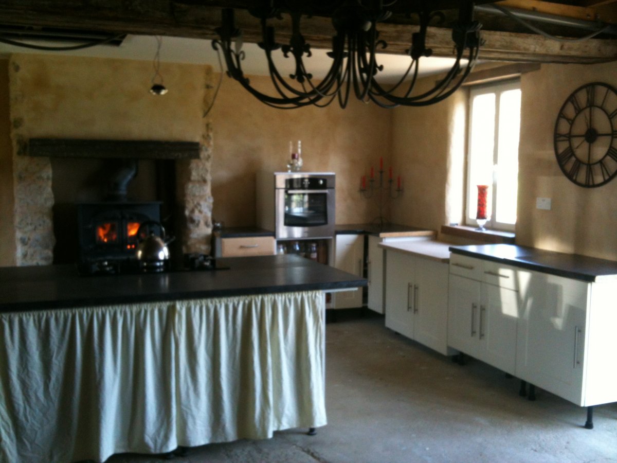

not doing anything after the white render (see pic of other side of the kitchen) not perfect but it a french country house
