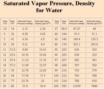

reading the SWIP design and installation guide, it is obvious that the success of this relies totally on the air-tightness of the insulation layer and preventing room air getting to the wall fabric. But what about through the ceilings and joist ends? or through the floor and behind the insulation?
Look at the table. The saturated vapour pressure is >10mmHg higher at 20 degrees than e.g. 5 degrees ( and a % of that depending on the relative humidity), which means your room, everything being equal, will be at a higher pressure by a few mb than outside because it is warmer. This pressure differential is part of the problem as it will tend to try and migrate room air containing water vapour outwards through the fabric of the building which is why you have to look at more than just the walls.
I'm sure this system is often installed with great success, but I'd still go in with my eyes wide open to the possibility of interstitial condensation and what happens then.
