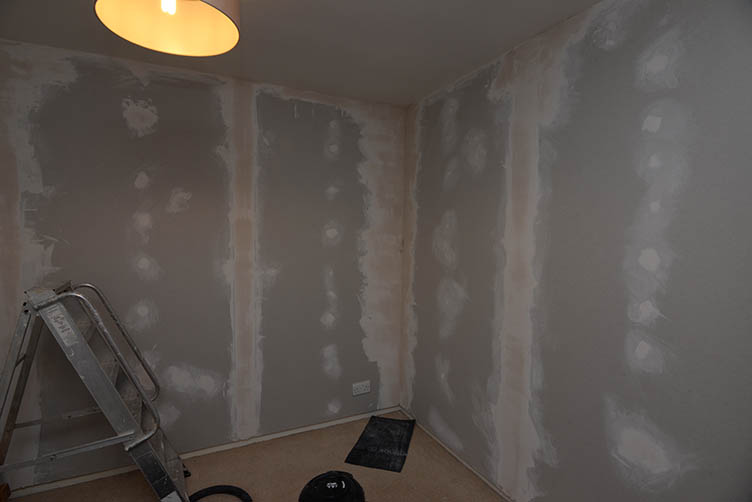

Even the internal walls of block are very cold so I have just internally rectified a bedroom by using cellotex (25mm), batten (25x40) and jointed. Has worked extremely well and it has become a much warmer room. I also did the same with a corridor that is v wide and leads to another back bedroom which faces north and is freezing. I can assure you this works well. If you need photos I can add here.

What I have done works really well and I don't notice any shrinkage of the room visually. With p/board and cellotex you are talking about 25+12mm which isn't noticeable.

I guarantee that 25mm will do the job. I am only paying about £6 a sheet (1200x2.4) from Travis Perkins. 40mm will not give you any discernable difference, whatever documentaion may say. The effect in my room and corridor is astounding.

The bedroom was awful before. Now walls are not cold. Effect is dramatic. Buy the 12mm plasterboard with feathered edge so you can joint it and fill. If you haven't done this before I can advise so you get a great finish. No need to plaster whatsoever.

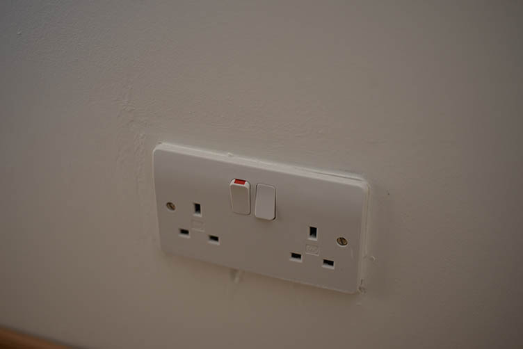

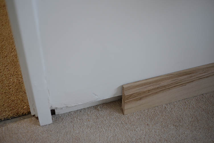

Whoops forgot photos so here they are. Some things to not-sockets and lights have to accounted for. Not hard to sort out so long as you have enough spare wiring to pull through. I just did. I fitted plaster board boxes. The other thing is skirting board will be covered. I am replacing mine anyway-may use some left over sweet chestnut cladding (see image) I strongly advise you not to go to 40mm, just 25mm. I didn't do the window side because I am changing windows (hoping to make my own-if you know anything about routers, let me know!) Even without changing the window external wall side of the room the effect is, as I said before, dramatic. Any questions, just ask. Email via the board if you wish as I am not automatically being updated to the thread.

Its pretty easy. Just measure length of walls and how many sheets of Cellotex you require, together with p/board.
I used a jointing plaster-approx £15 from memory. Scrim tape (self adhesive to run down joints)
Wood-I used treated 25x40mm.
Work from corner out and place verticals (only needed) at 600 mm intervals.
This means the first sheet of plasterboard (1200mm) fixes to second batten
Plasterboard screws
Boxes for switches ( i upgraded mine from singles to doubles)
Use spirit level
If walls aren't square you may need to trim bit of board away but you can fill later. Get first sheet to sit square then next one is easy
If you haven't jointed ask me. (Have now done a few times now and can get it perfect)
4-5 working days should see it done comfortably
Ask if in doubt

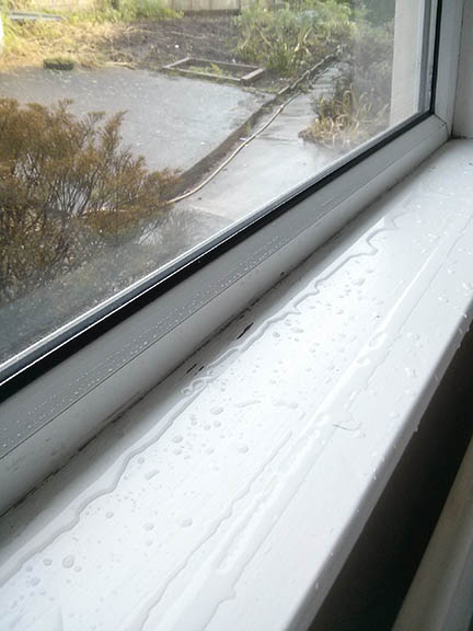

Not directly related but in some ways may be relevant to you. I attach a photo showing condensation in room I have done on the windows. The windows although double glazed units are very old and inefficient units. I attach 25mm cellotex on them overnight and all the cold air is locked in, so to speak, between the cellotex and the window. It runs down the window. There is none on the warmer cellotex. I am trying to get advice on the forum re making windows. I can make basic ones OK and can buy sealed units at trade and they are efficient and v cheap. I will literally save thousands if I make them all myself. Know a joiner for advice? Only one thing I need to know...
