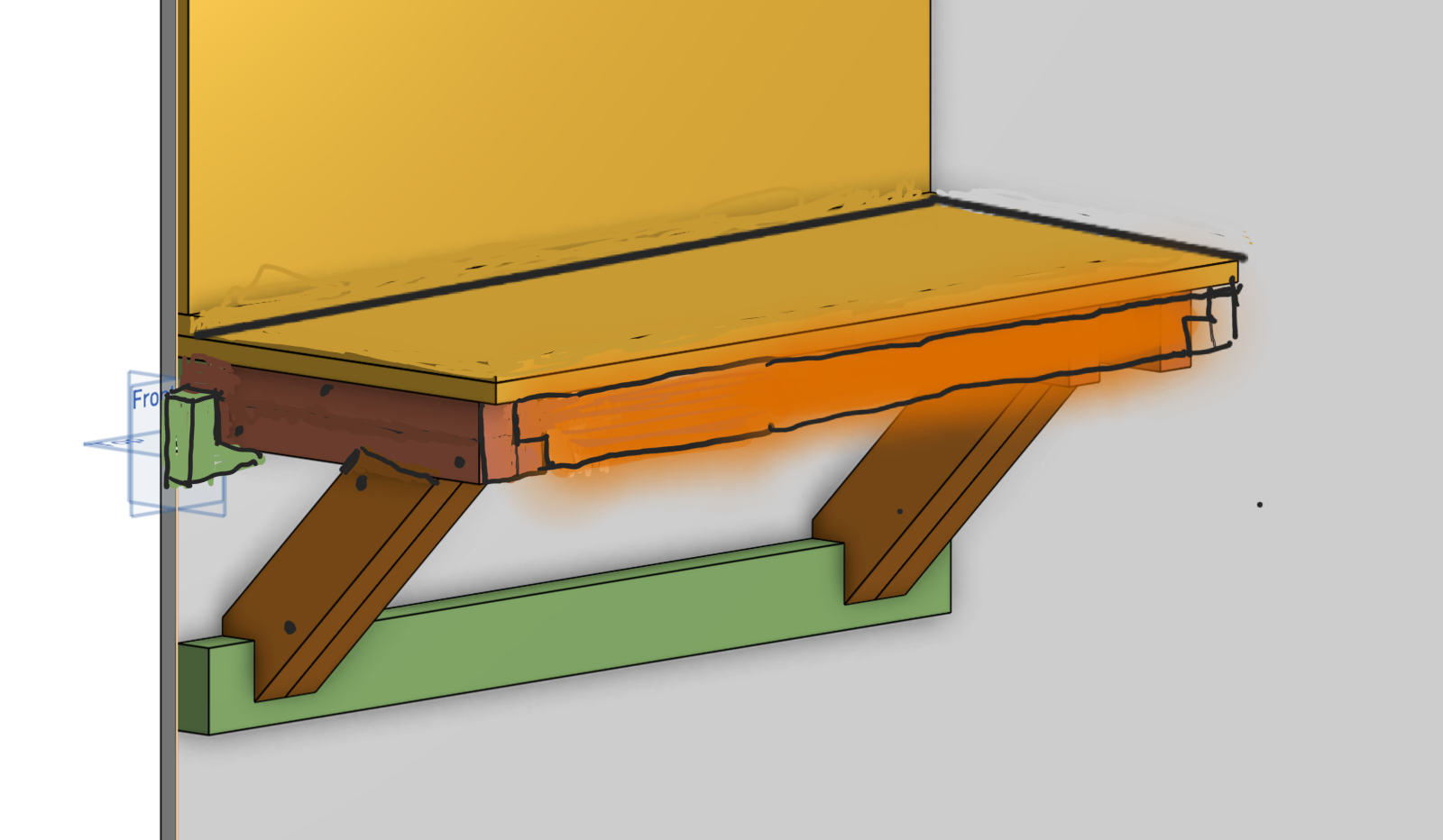

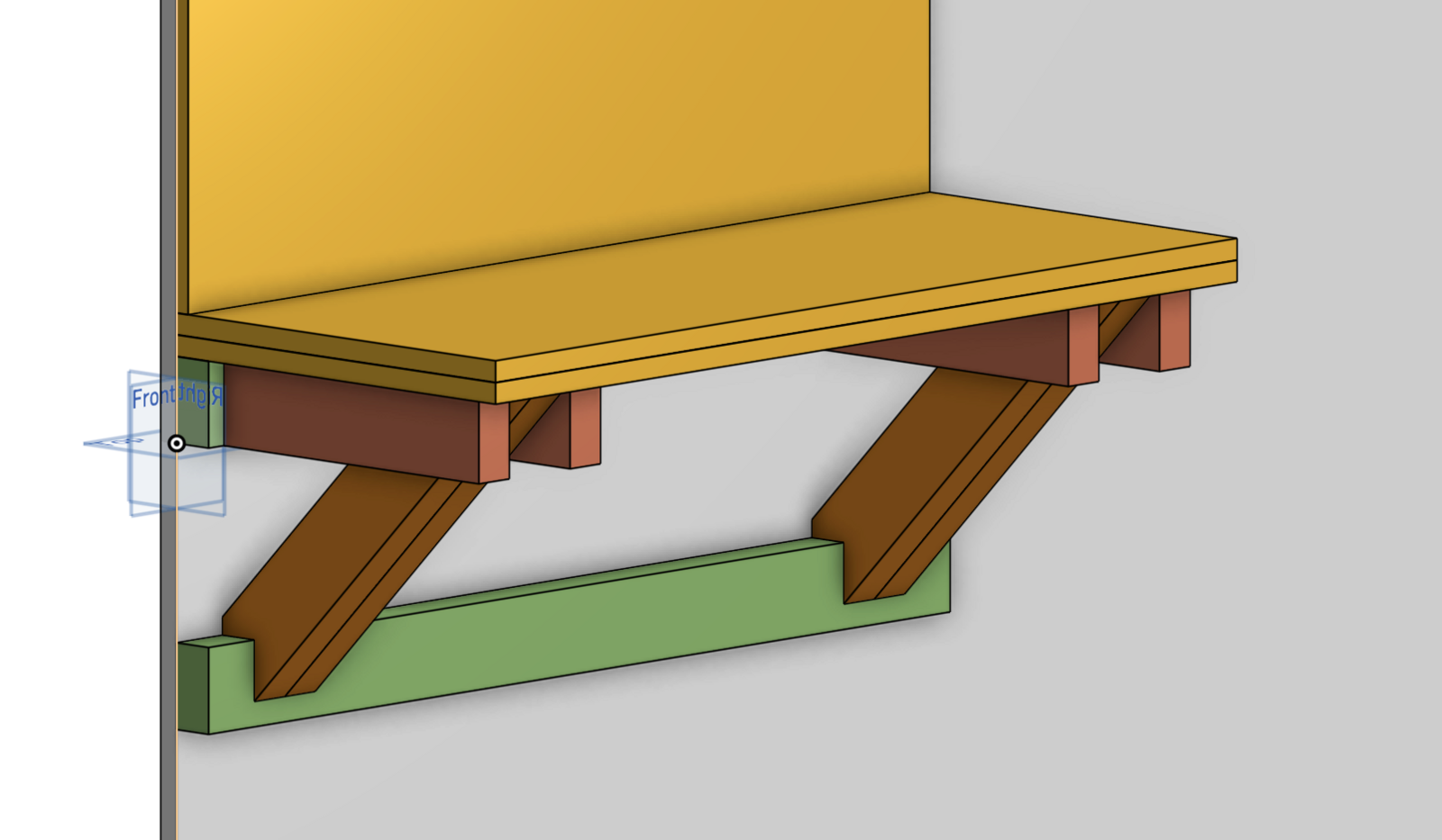

Internal wall stud spacing, new build (2017+). Is 1200mm normal?
make the bits in green quite chunky, they can be fixed on the 1200mm centes, and the bench fixed for the 1500mm. It will need each green timber in your picture to have two screws at each fixing to the wall.
Sorry for the delay in getting back, so I do have studs between so there are studs every 600m. The plasterboard is just not screwed to the intermediate studs so magnet was not picking up anything.
