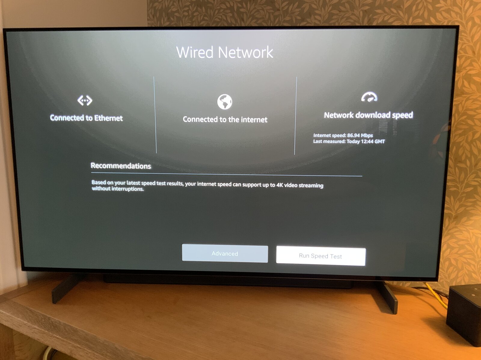

I noticed that I was getting around 80Mbps on my phone and iPad when they were on 2.4Ghz but when I swapped to the 5Ghz I’m getting nearly 140. Checking the speed on my fire TV which is wired, it’s 83. Disconnect from the wired and pick up WiFi, it’s 138. Why doesn’t it run at that speed when wired - there’s no choice between 2.4 and 5 on the wired side of things. Is there?
Older network interface on the FTV? Cable/infrastructure issue? You need to compare like with like.
The TV Ethernet connection is probably only 100mb whereas WiFi can go much faster on a 5g WiFi connection. You are also limited to whatever your broadband speed is.
I recently came across exactly the same - my wifi (from main router), faster than my wired (via a repurposed router). The main router was a 1Gb wired LAN and wifi 6. Problem was the old repurposed router, was limited to 100Mb. I have since, replaced the 100Mb router, with a 1Gb switch, and now get full speed.
5Ghz is faster than 2.4Ghz, but 5 is much shorter range.

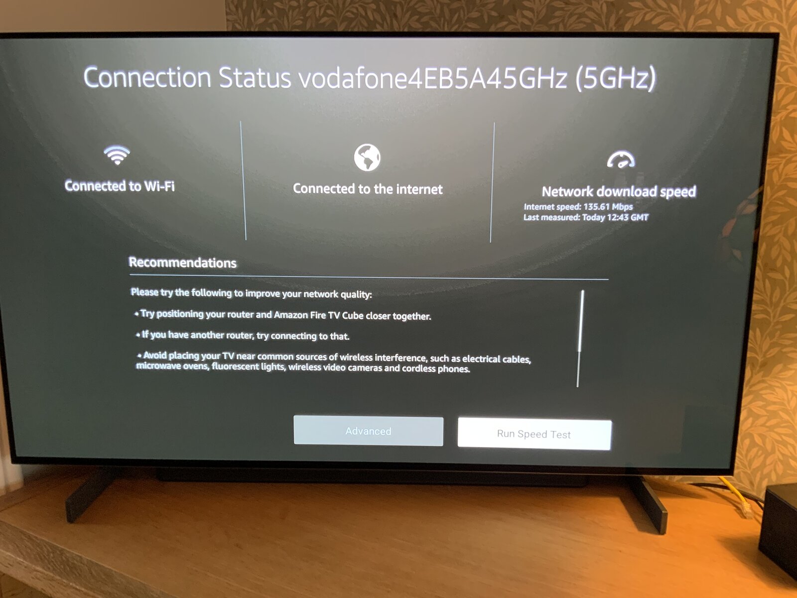

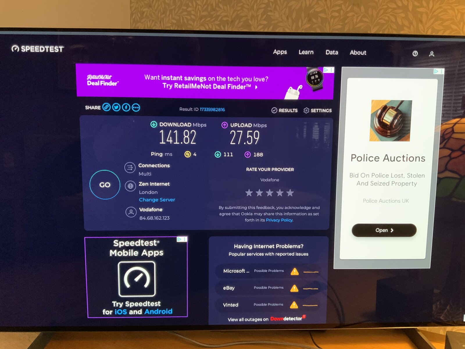

Well, after a bit of tinkering (moved the whole TV/Fire TV cube setup into the hall next to the router) I confirmed that running a speed test onto the TV whilst connected to the ethernet gave me a speed of 141 Mbps. Plugging the same ethernet cable into the Fire TV cube gave me 86Mbps so that confirms it is the Fire TV cube that is throttling the ethernet speed. Running the cube on WiFi gives me 135Mbps so I’ll just have to run it on WiFi. Searching online, it seems it’s a common occurrence with the Fire TV cube. I shoulda checked that first. Live and learn…
Wired connection to Fire TV:
WiFi connection to Fire TV:
Wired connection to LG TV:
