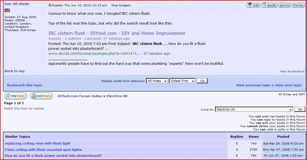

Curious to know what one was, I Googled IRC cistern flush.
Top of the list was this topic, but why did the search result look like this:
IRC cistern flush - DIYnot.com - DIY and Home Improvement
4 posts - 2 authors - Last post: 57 minutes ago
Posted: Thu Jun 10, 2010 7:03 pm Post Subject: IRC cistern flush .... How do you fit a flush
power socket into plasterboard? ...
www.diynot.com/forums/viewtopic.php?p=1641471... - 57 minutes ago
