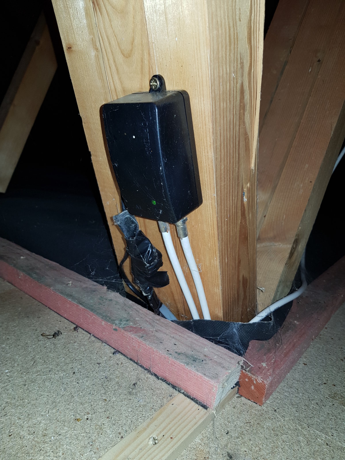

Son has a new-ish (12 years old) house; the previous owner wired a TV amplifier in the loft into the upstairs lighting circuit using a "chocolate block" wrapped in insulating tape (see photo.) Understandably the TV repair firm asked to update/repair the aerial and amplifier won’t touch it, and want a socket in which to plug the new amplifier. There is no ring main wiring in the loft, AFAIK.
What I am considering is putting in a connection box (3-terminal 30A) and connecting this to a Switched Fused Connection Unit (SFCU) - I happen to have an old one - with a 3-amp fuse in it, and connecting this to a (single) socket - (and labelling them both with "3-amp MAX" notices.) The connections will use 2.5 T&E cable.
Is this a safe (if unorthodox) way of working, please?

If you want to use a socket then do so, but you won't need a SFCU as well and only need a junction box if distance means it is necessary.
1mm² flex and the smallest junction box will be more than adequate.

A junction box is needed as there is little cable above the floor; I have a 30A junction box and SFCU, and bought 1m of 2.5mm² cable as all of mine is of the old colour-coding and at the time I didn't know whether the supply circuit was lighting or ring main.
My thinking about using the SFCU is that, just in case someone did plug a high-current device into the socket, the 3A fuse in the SFCU would save the lighting wire from a heavy current overload.
IT's unlikely in a loft. And your 6A MCB would trip quicker than the 3A fuse.
But fit it if you wish...
Maybe use a 20A junction box lol
Plus, if you use a socket, there will be a 3A fuse in the plug.
May be not if it is a "plug top" power supply. Some plug top power supplies are designed fail safe but some, those with no fuse or fusible component can melt down and even catch fire before they disconnect from the mains,.
Hence feeding the socket from an FCU with a 3 amp ( or even 1 amp ) fuse is sensible given the hazards of un-fused plug top power supplies

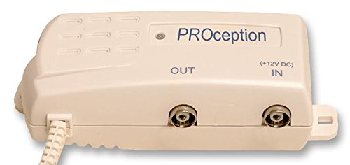

My TV aerial splitter is powered from the socket in the lounge, up through the aerial cable ... somehow. Why not just get one of those things?
Here it is, well, my photo up a bit, Lucid's explanation here: https://www.diynot.com/diy/threads/television-aerials-boosters-etc.506293/#post-4189283
one of these:
linky
So, in the lounge (or whereever) this sits between the TV and the aerial socket, plugged in, it powers the aerial on the roof, which sends power to the splitter that can be attached to the aerial pole, or sit in the loft (like mine is).
No dodgy loft electrics needed.
