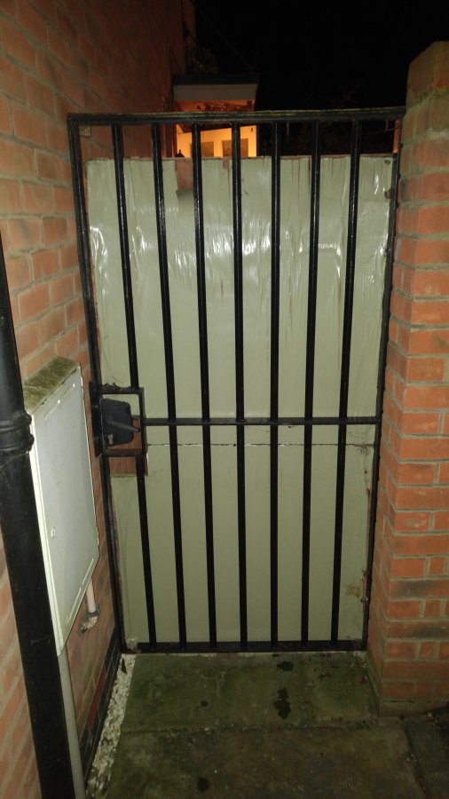

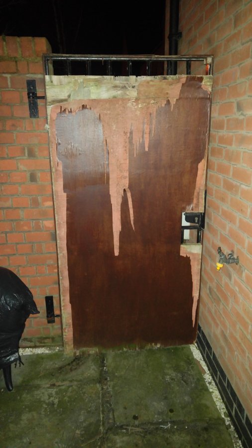

Hi all
When I moved into my house, the back gate had just had a wooden panel fitted around it (bits on each outside edge, screwed into the main panel). A few years of bad weather mean it's now in a horrible state. I'm aware I should have sorted this ages ago but have had other priorities.
Just wanted to get some opinions - am I best off getting the same thing done again? Or would some sort of UPVC panel be better for simplicity/longevity?
Pics of the current one attached... you can see where gravity has pulled the main panel downwards off its screws. What option would you go for?
thanks

Forgive me Matt but it's a fairly ghastly looking thing.....can you leave it uncovered?
If you wish to clad it, consider vertical timber boards, weather proofed with a small gap between them.

Hi John, thanks for your comment - I fully agree. Unfortunately it was here when we moved in! I could leave it uncovered but we sit out there quite a bit in the warmer months (bbq/chimenea) and whenever the neighbours walk past we'll feel like goldfish.
I'm no chippy myself but I did think the existing panel was a bit of a **** design - pretty much its entire weight was hanging from the screws in the top. I'm tempted to just remove it completely for now until I can get a solution sorted. I was just going to ask a carpenter to quote on doing a similar thing, but thought perhaps there would be a more straightforward solution. My main concern is over how to actually fix the panel on.

Hi again - been having another look at this in preparation for doing the job in March.
I'm wondering if it's going to be an issue mounting the slats inside the frame as the welds at the ends of the bars are quite big in places so they might not fit well. You can see how the last guy did it - the top/sides have their own "frame" which is flush on the one side, but then overhangs by a few mm on the side you can see here. He then screwed those frame bits directly into the panel in the centre - hence the weight of it ripping itself free once the wood started to separate.
I'm torn over whether to try and copy what he's done, or to just try mounting them inside the metal frame and screwing in directly from the top and bottom as suggested. I'm not the most handy of people so the wooden frame idea probably wouldn't go well. Where the hinges meet the gate, he's cut holes in the wood accordingly but I'd probably make an arse of it.
A few lengths of wood isn't going to cost much so I guess I'll just try that option first and see how it goes! But will it not be a problem screwing into the end-grain of planks of wood? Thought the weather might get in too easily perhaps? Sorry for the stupid questions - I'm happy to have a go with this stuff but this is a new one to me.

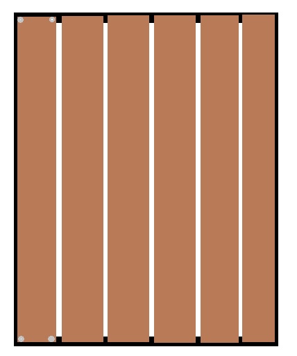

Excuse my ignorance here but I'm struggling to picture what you mean - do you mean having it so the wooden panels overlap the metal frame, then are just screwed directly into it? So rather than screwing into the frame from the top or sides, I'm screwing them on from the front? See my amazing mspaint picture attached for what I mean. I could only be bothered to add the screws to slat 1 but it explains what I mean! Oh and haven't done the vertical bars either but you get the point :p

That's about it, Matt....effectively you are cladding the metal frame so the wood is on display outside, and from the inside you can see the metalwork. So, if you can drill the steel, you can pass screws into the timber but if the timber is a bit too thin and the screws could protrude, you can use countersunk threaded screws and nuts to hold the timber on. Each plank would need two screws, top and bottom minimum and some in the middle, screw heads on the outside.
Is that OK?
John :)

Sounds good to me! Counter-sunk is the way to go I think - I have a metal case with pretty much every size screw you could dream of (thanks dad) so plenty fit for purpose. This sounds like a much much better option and seems obvious in hindsight! Thank you John I really appreciate all your advice. I'll post an update when it's done.

I was thinking about another possible and safer option than drilling directly into the 10mm frame... what about small L-brackets? I could paint them to match the gate and panel colour so they wouldn't be too obvious. This would avoid the problem of having to drill so closely to the edge of the frame. Do you reckon this would look a bit crap?
Personally I'd avoid extra brackets if possible, if only to minimise corrosion and the need to maintain.....they also don't tend to be very strong.
I notice the gate has existing holes drilled - could you use them where possible?
John :)
Hi John,
The holes are drilled in through the top and sides of the frame. My plan was to drill front-on, so into the 10mm wide bit of the gate (see the pic I drew above). I'm starting to think it's a crap idea because there's barely any margin for error. 6mm screws in a 10mm frame means 2mm between the edge of the hole and the edges of the metal. Any failures in measuring could ruin the whole idea.
It's only 12mm ply so I thought brackets might work but I take your point about maintenance etc. To be honest I'm half tempted to replace the whole thing with a new wooden gate but that defies the point of saving money.
