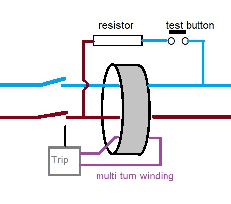

The usual test button circuit simulates an Earth fault in the RCD but does not create an Earth fault.
The RCD being tested does not have a Earth so it is impossible to create an Earth fault for the up-stream RCD simply by pressing the test button.
I have the old MK socket so can test, I assume a test button also checks and earth is present so Button will test to earth not just an imbalance?
Yes, we've been through this before. Many/most RCD sockets (and I think also RCD adapters) will not even reset without an 'adequate earth connection' - which I suppose makes some sense.
Also, as said, unlike standard RCDs and RCBOss, the test button in these things seems to create a 'fault to earth', and therefore are quite likely to trip any other residual current devices with which they are in series.
