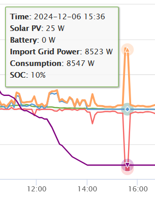

My electric shower is not very big, I note on the solar software draws around 3.5 kW from the DNO the rest from solar or battery. So likely only around 8 kW, we do have two electric showers, and a 60 amp DNO supply, never blown the DNO fuse, and looking at solar software unlikely it ever would.
The smart meter is a bit useless showing usage, bar graph on phone app, but solar shows far better history. Last time shower used had run out of solar and battery so this 1733663019445.png shows the load and power used with an electric shower. And my daughter travels to us to use our shower some 40 mile return trip, we hope to also see us, but clearly the shower she feels is better than her bath.
