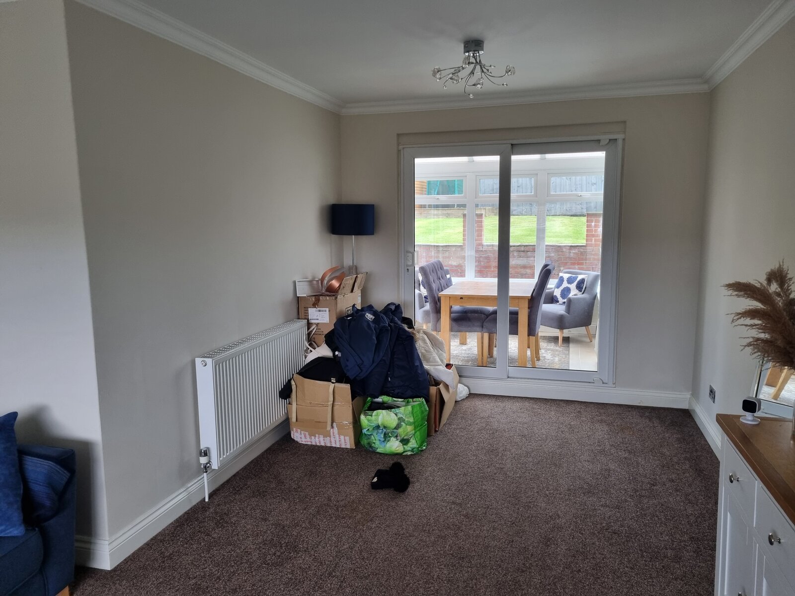

Hi everyone, just a couple of questions regarding planning permission etc.
We have just moved home and are getting a full rewire, however we are want a few things dine first. We currently have a living / dining room however we want to knock through and make a kitchen / dining room. Then we want a larger bifold doors fitted to where the sliding doors are.
It's a solid wall apart from a small area where must have been a door, I will attatch a picture to show you the wall I want down.
Also currently has a conservatory what we may get taken down, all depending on if we can get a extension built,
Would any of these works require any sort of permissions ?
Any help appreciated.
Thanks dean

No planning, but you may need building control inspections depending on whether the walls are structural or not, and if you make the external door opening wider. They will also be interested in your new door!
It's your responsibility to ensure it's done, but most builders will help you sort it, but you may need to contact the council yourself.
It's pretty straightforward, they will just want to see any structural calculations/specifications of lintels, and then will pop in at key times

We can't know for sure. You will have to look in to whether the extension you intend is permitted development. Don't confuse PD & planning with building control. They are different departments that don't talk to each other. Def your works come under building control. They may or may not require planning.
It is your responsibility to get building control sign off, but you can delegate this to a builder by negotiation. A builder may not take it on the responsibility to organise this automatically, but they should, with a duty of care, make sure you are aware of the necessity.
