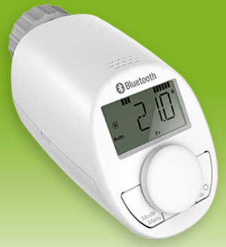

The TRV comes as two parts
the bottom part has connections and a pin connects it to top part,

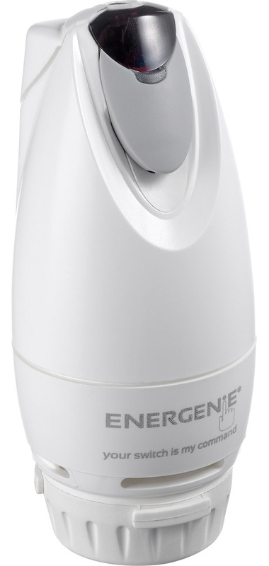

once the valve is fitted there are a host of top parts which can replace the top part, from a cheap eQ-3 61dmtMm13BL.jpg around £15 to Drayton Wiser upload_2022-3-12_8-59-57.png £43 as to what they can do I have two the eQ-3 and the Energenie mihome, upload_2022-3-12_9-3-20.png at £85 a pair plus they need a hub at another £40, I prefer the cheap eQ-3 as I can manually set everything on the TRV head, mine are bluetooth so can set them with phone if near to them, and with bluetooth version they can be linked together for example when two radiators in the same room.
As standard it seems M30 x 1.5 mm connection for the head is used, the eQ-3 had a load of adaptors, the Energenie only two, the eQ-3 auto adjusts its self and if travel too much or too little shows a report code, the Energenie did not tell you if within range or not, and in spite of costing a lot more, was in most things not as good as the eQ-3.
There is another stand alone called the Terrier i30 never used one so can't say how good.

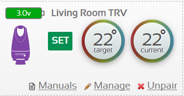

The energenie can use IFTTT (if this then that) and with that one can set up geofencing, that is detecting when your phone is near and turning up the heating, but the energenie also has OTT anti hysteresis software, so to get 20°C at 8 am I had to set it at 22°C at 7 am then down to 20°C at 8 am. So can't see the geofencing working very well, the Drayton Wiser claims to work out how long it takes to heat the room and uses algorithms to ensure at temperature on time.
The lock shield valve was also important, as it takes a valve around 5 minutes to exercise the valve, the e-Q3 do it mid day on Saturday it opens valve wide, and closes valve then back to setting so the TRV does not stick. If the radiator heats up too fast, then the temperature over shoots, so lock shield set so radiator takes around 20 minutes to hit max temperature.
In mothers house with a modulating boiler the energenie mihome were spot on, TRV_report.jpg if it over shot I closed the lock shield a tad, and if not hitting target opened a tad and once set worked very well, but this house with an on/off boiler the results have not been as good.

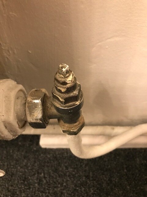

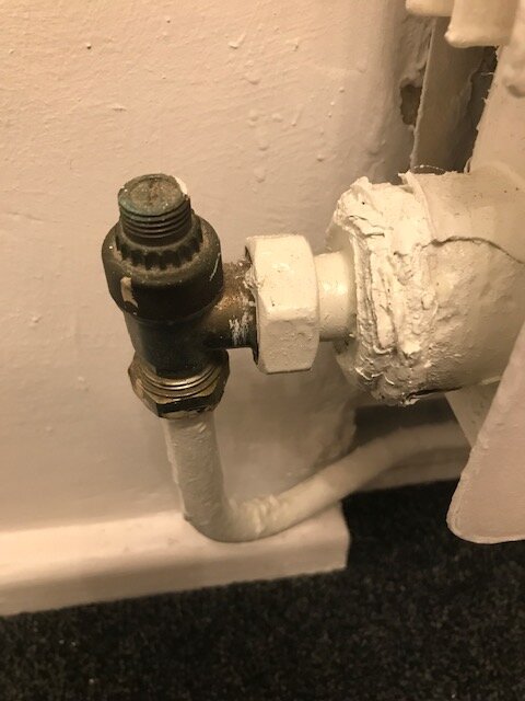

thanks guys... unfortunately there is no valve at all on the radiator, so I have 0 control of it (atm I leave the windows open most of the time to create a cool temperature which I prefer).
Apparently the control boiler will be switched off for the summer next month, so hopefully the landlord can just stick a TRV on mine. If doing so would affect the other flats on the same floor, honestly I'd rather just have it off altogether if that's possible.

Thanks guys... tbh what I know about radiators would fit on the back of a postage stamp. I've attached pics of the metal bits on either side of it.
