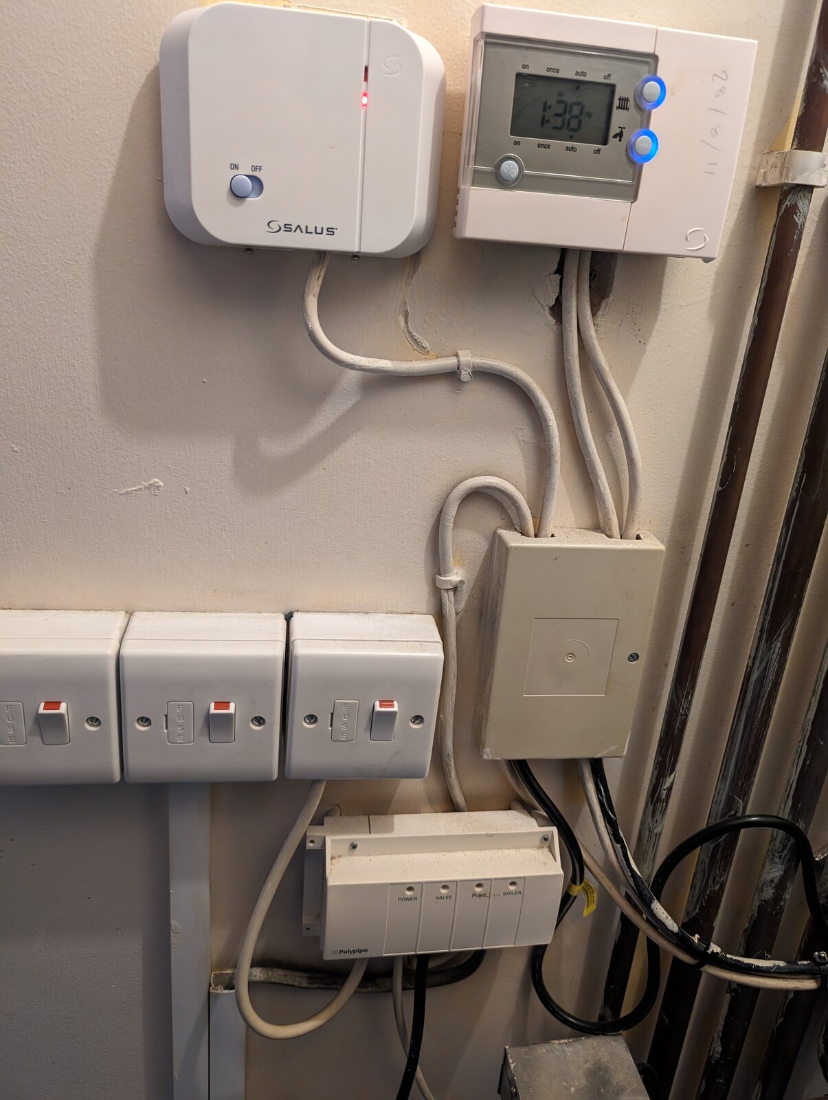

Hi all, just moved house and brought my Tado system with me and will look to get it installed in the next few days or so.
I installed it myself at the old house using their very good and detailed instructions that they provide.

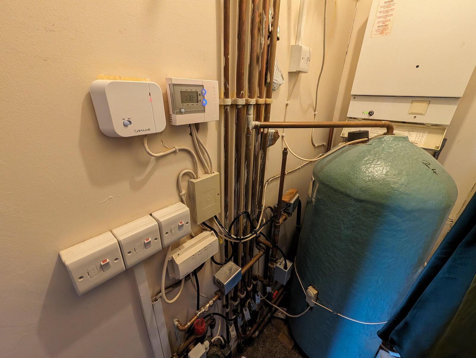

That house was a combi though and this house is conventional and seems to have its own plant room in comparison!
Should it still be pretty straight forward and its just the look of all the boxes and pipes thats daunting?
I believe it will just be a case of replacing the digital Salus receiver with Tado and then disabling the thermostat box.

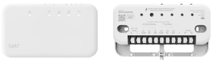

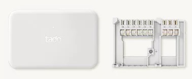

There are quite a few variants of Tado. Some have hot water control included. They are used when there is a stored hot water cylinder heated from the boiler. Other versions of Tado don't have hot water control generally used with combi boilers.
Examples of Tado with hot water control are:
If you have a different version of Tado to those above, post back its details.

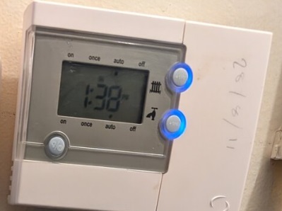

Assuming your Tado is a version with hot water control built in, then it would replace the wired Salus EP 200 Programmer that also has both HW and CH control.
Then the Salus Room Thermostat receiver should be removed. However, the switching wires in its terminals NO and COM need to be joined together. It can be done by replacing the Salus receiver with a junction box, isolating L and N and then joining the wires from NO and COM together. Or the cable to the Salus can be removed and the link made at the other end of the wire
This assumes that the system presently only has the one Salus room thermostat installed that controls the entire central heating system. Whilst it looks like that from the details of the controls you have provided, the plumbing suggests that there might be more to it. For example there are 3 motorised valves visible, instead of the usual two (HW & CH) There is also UFH which usually has separate control from the radiators.
It needs some thought, as to what your aim is? You could assuming your tado is a single channel programmable thermostat leave the Salus in place to do the DHW and just move the CH to the tado.
