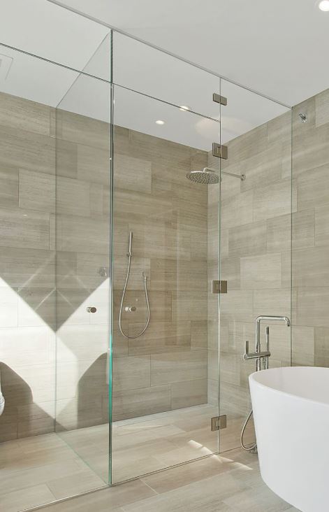

Hi, I want to create a shower cubicle similar to the below. 2 walls of the cubicle will be tiled (porcelain or marble) and 2 will be glass panels. The shower tray will be 900*1600mm. I plan to install the shower tray onto the joists (1st floor suspended timber floor) into the corner and level the floor and then fix cement board to the walls and tile onto these and onto the shower tray. This means the cement board and the wall tiles will overhang the shower tray. I will also make the glass panels overhang the shower tray slightly and mastic round the edges.
