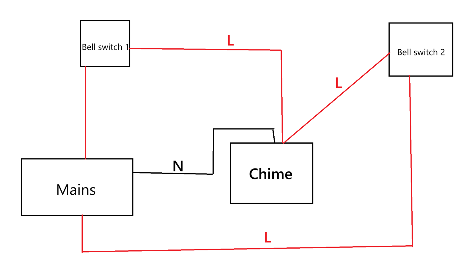

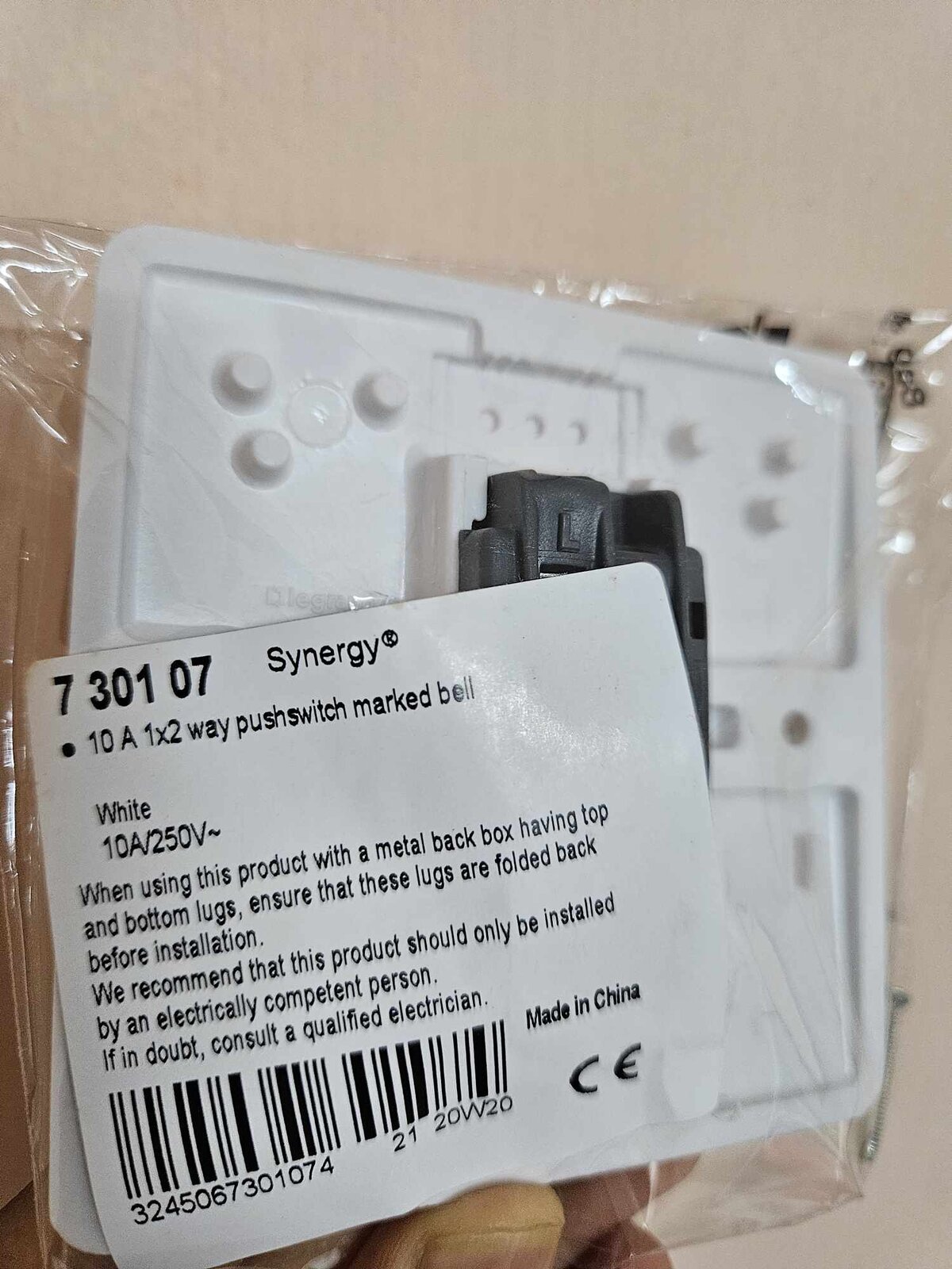

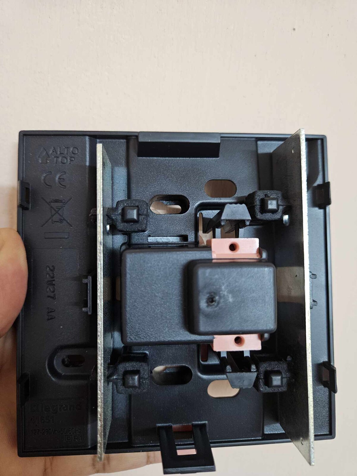

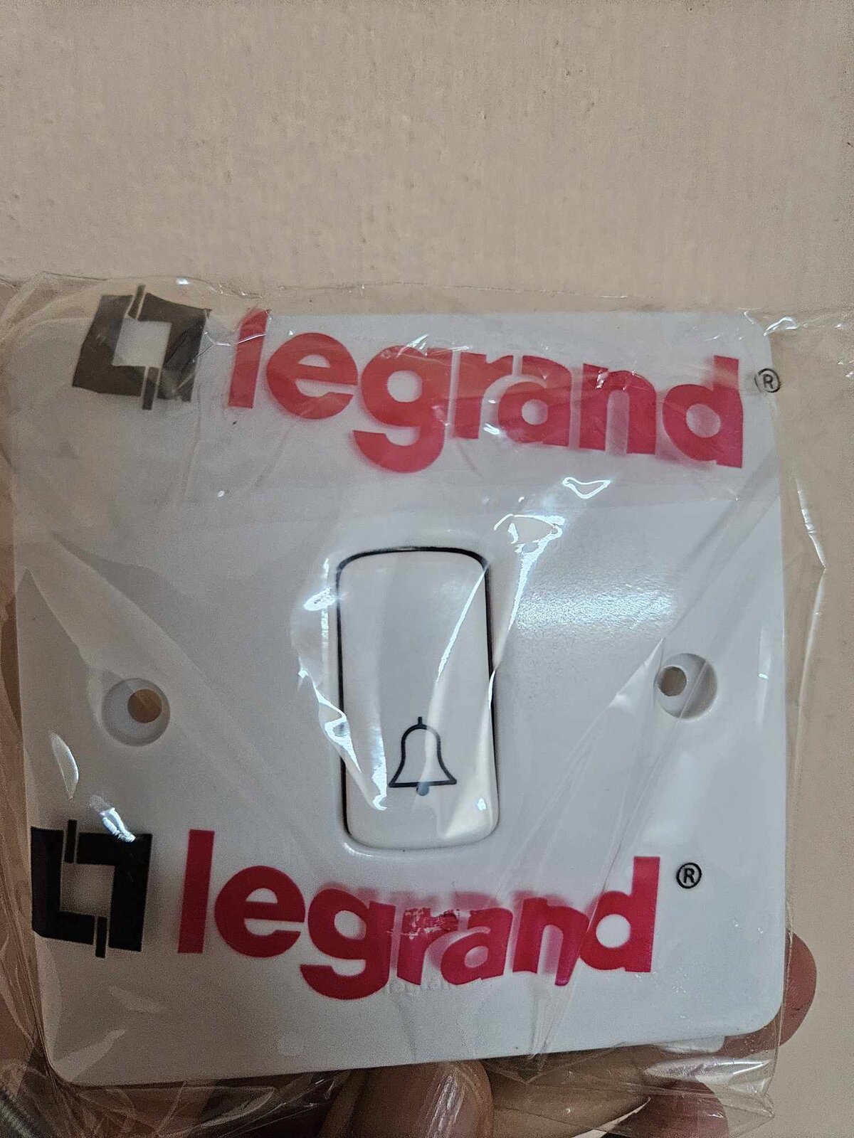

Hello,
I have bought a Legrand chime and two doorbell switches (i have two entrances to my home; one front door and one back door) and i want to have one bell switch outside next to each door and then have both bell switches work with the same chime. I would rather not have one chime for one switch only. But i am wondering if this will cause any trouble?
476332576_977634857649296_1259427282161756620_n.jpg476569740_1128039705478044_5817020690405995725_n.jpg474528299_1420057376068649_37622391064764081_n.jpg474878405_1124143199034690_1619364418983506648_n.jpg

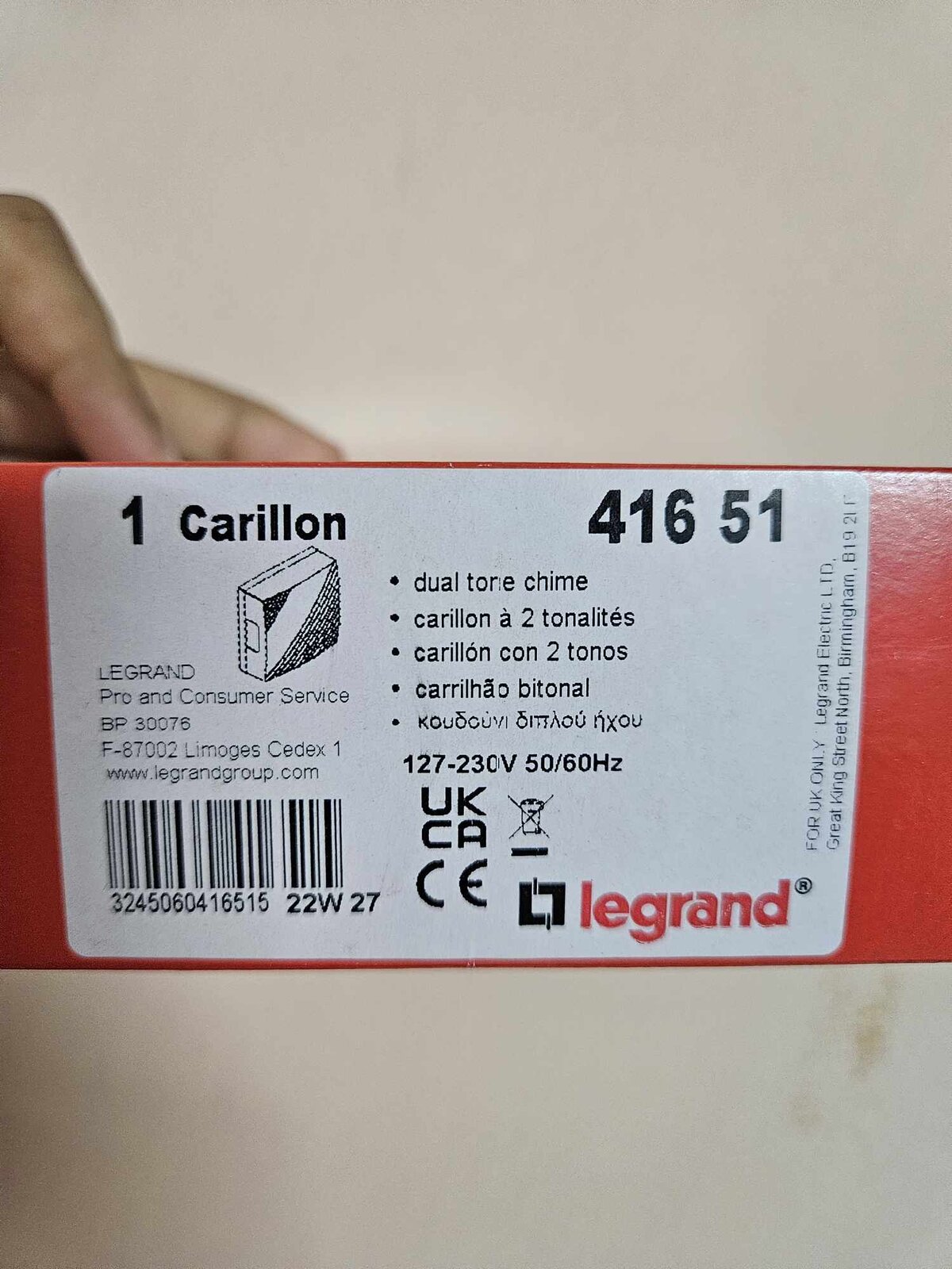

I have found the official technical documentation of my Legrand chime: https://assets.legrand.com/pim/NP-FT-GT/U4359B.pdf
(i have also attached the PDF file to this post for convenience)
There are two versions of this chime - with and without integrated transformer. I have the version without the transformer (since it was cheaper).
In the U4359B PDF, on page 2 under 41651, it is the chime that i have. Is it possible to connect 2 bell push switches to it? There is only AC 230V connected to it.

But what if both bell switches are pushed at the same time? Won't it create a short circuit?
Edit: I have made a sketch to show the connections to illustrate my concern.

The problem you may have if you have a very remote doorbell push is volt drop. I did this once and there wasn't enough power going through the long cable to get the electromagnet to work properly. The answer was a second chime in series with double the voltage. It worked perfectly.
as the voltage to the bell/buzzer and bell push will be low voltage between perhaps 6-12v at the buzzer perhaps individual supply to front and backpush
the furthest away could be perhaps 10-15v as the volt drop would reduce to perhaps 7 to 12v dependant on length and wire chosen
with the nearest being say 9v giving perhaps 6-8v
now the sound will be different assuming voltage difference
now you could also have a separate control supply from the furthest away to a relay that will complete the circuit from the main bell push from the remote button but this will need a low powered separate supply but zero tone difference as the same voltage to buzzer from all sources
a further option, two separate circuits in any location with different bell/claxon/buzzer
and a further option mains plug in unit with 2 or 3 battery bell push --the modern choice at perhaps £15
