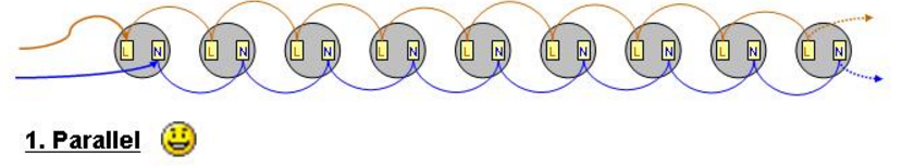

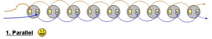

is it possible to wire 8 lamp holders into a single plug? If so how would I do it?

I have misinterpreted your original post.
I have took that you mean each lampholder has a seperate cable, and so all eight cables go back to the plug.
Of course, thinking about it, you probably meant wiring the the lampholders in a 'chain' - so only one cable at the plug.
Sorry for the total confusion I've probably caused.
Something like this?
You need to wire them in parallel. It is explained in the WIKI
//www.diynot.com/wiki/Electrics:Parallel-Lights
