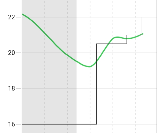

With an on/off boiler, that is not an option, boiler need to option to modulate to do that. I did an experiment earlier, I put the heating up 0.5°C 1771862842001.pngand watched to see how long it took, clearly the thermostat turned the boiler off before the flame icon went out, as it showed still heating, but the inlet to the radiator was cold, Wiser does claim to work out things like this, and it clearly does. It gets outside temperature from the internet, and it has transformed my heating. I must give it full marks.
But the circulating water temperature is a manual dial.
The heating has a few minutes ago jumped from 21°C to 22°C and radiator is fully hot, but when I went from 20.5°C to 21°C for that test even after an hour the bottom of radiator was not hot, so Wiser must have been using some mark/space switching to stop it over shooting.
The thermostat has 4 options on boiler heat source type, and then option OpenTherm or on/off, so it is set for an oil boiler, on/off control, the Useless Nest Gen 3 also wanted to know oil or gas, and I have really no idea as to how it uses the info, but Nest would over shoot, so I set it to raise at 0.5°C at a time, but Wiser does not over shoot.
