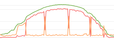

Again we use solar here to heat DHW, the regular spikes
is the immersion turning on to keep the DHW hot, using the solar power, I actually think it would cost less to just use off-peak, but to change the system will cost, so sticking with what I have. I have seen a huge drop in oil use since using the solar, I had no idea how much DHW was costing me.
