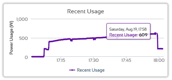

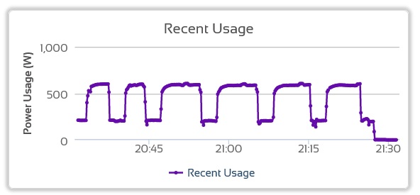

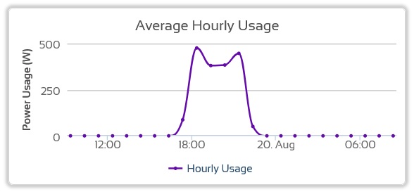

I swapped from a vented to heat pump dryer in the main to be able to close the window, and not drill a hole in the wall, the water running into same drain as washing machine is great, the old vented was set to just 1 Kw so was not fast, but put on a load at 17:10 and it finished at 21:30 that's 4 hours drying.
The dryer seems to use a mark/space ratio to heat and cool after the first hour, so starts Two dry level 2 Sat.jpgbut then Eight dry level 2 Sat.jpgat the end, the spacing varies Five dry level 2 Sat.jpg so clearly some monitoring is going on and adjustment, with some very varied drying times. The overall use All dry level 2 Sat.jpgshows around 400 watt average over 3.5 hours so it does seem to use less than the vented, and it was a rather full load, the main problem is if one splits the loads, one then forgets to put in the second load, and no two loads are the same, so near impossible to work out if worth splitting the load.
