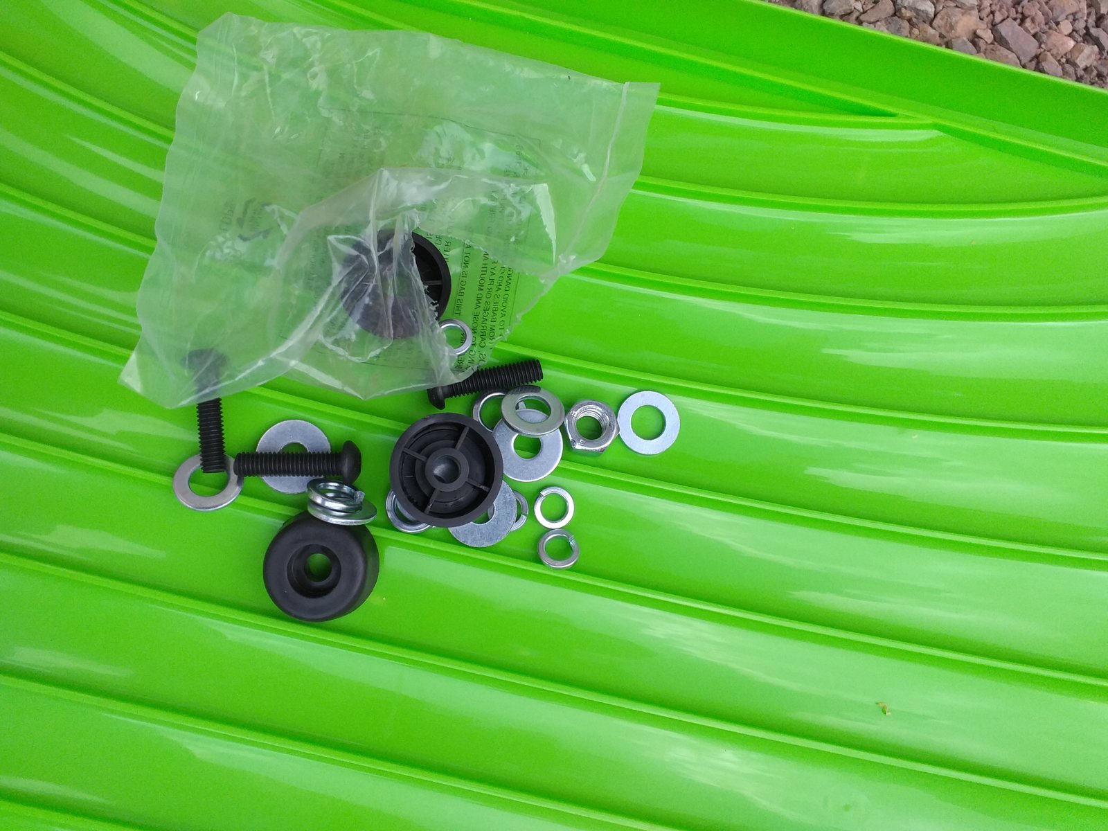

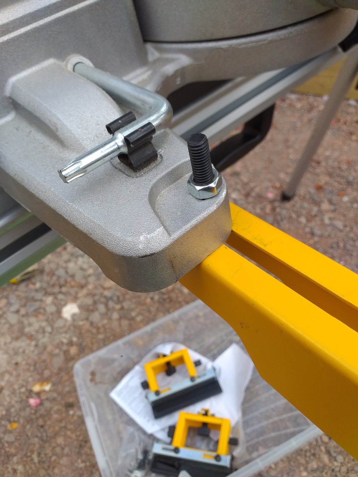

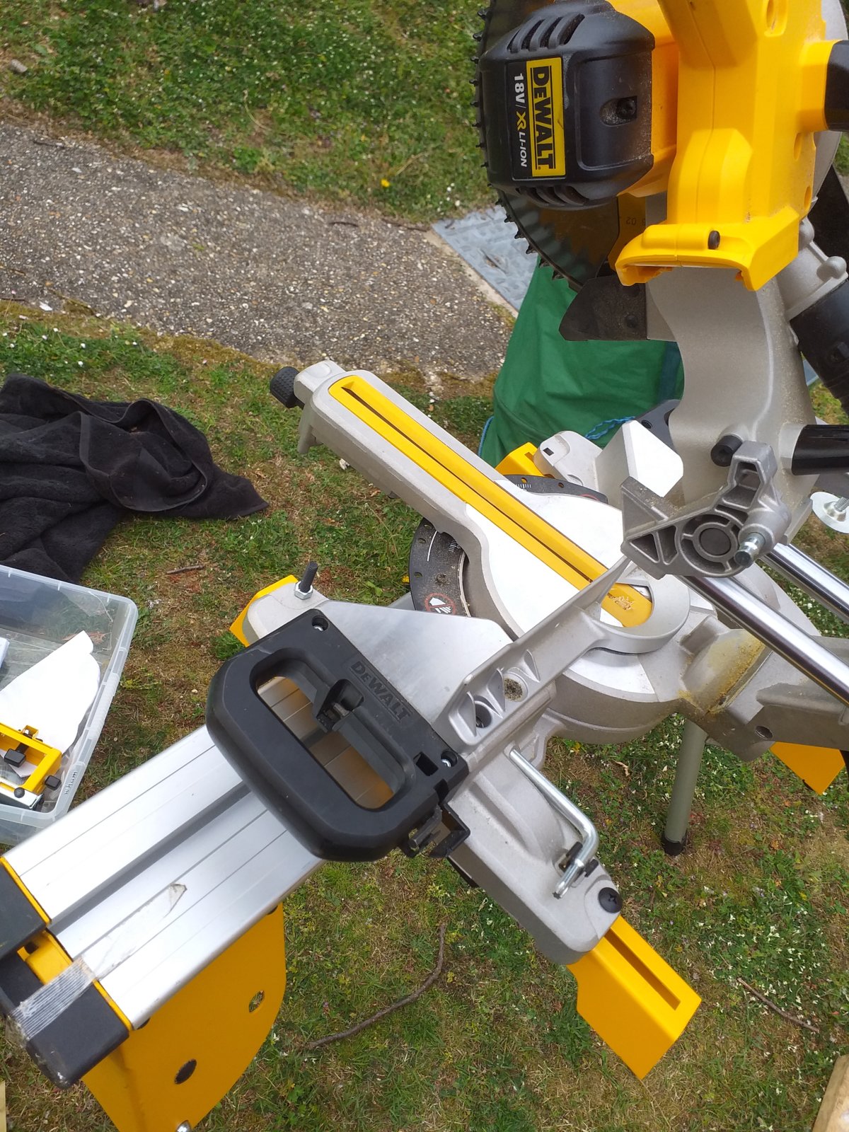

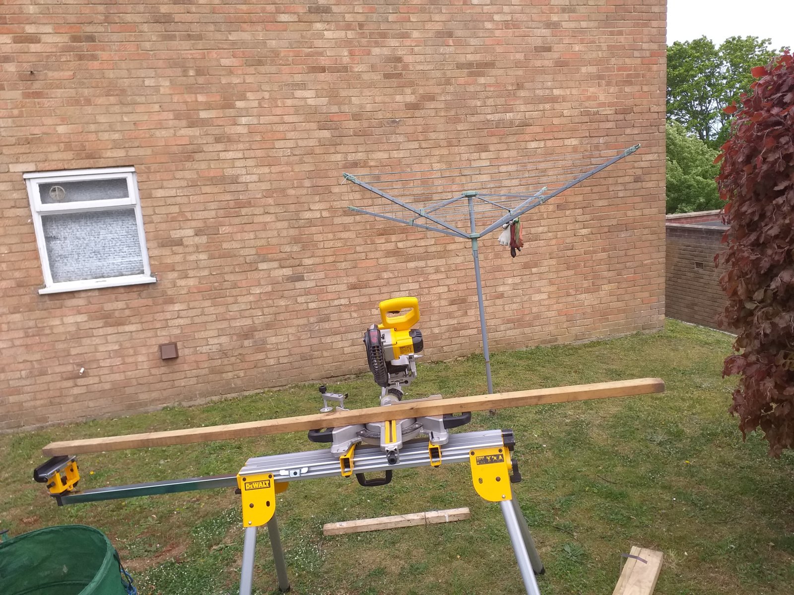

Got a universal mitre saw stand. The arms which come out the end seem to be level on top of black thing rather than it being a stopper. Also had lots of screws etc with kit but I only have four holes on saw so just used four of them.
you would be better with the saw back a bit otherwise as you place wide timber onto the front leverage may try and tip the saw
adjust the side arm supports properly with the black bit folded down as thats a length stop to give you repeated accurate lengths as you stop against it not on top off it
It's only level with wood ontop of black bits strangely.
Will this set up hold a sleeper?
as i say adjust the side supports up till level and move the saw back about 3 or4 inches
depends on sleeper size up to perhaps 120mm if you flip it [turn t over]
but you may still have uncut triangles at the back off the cut

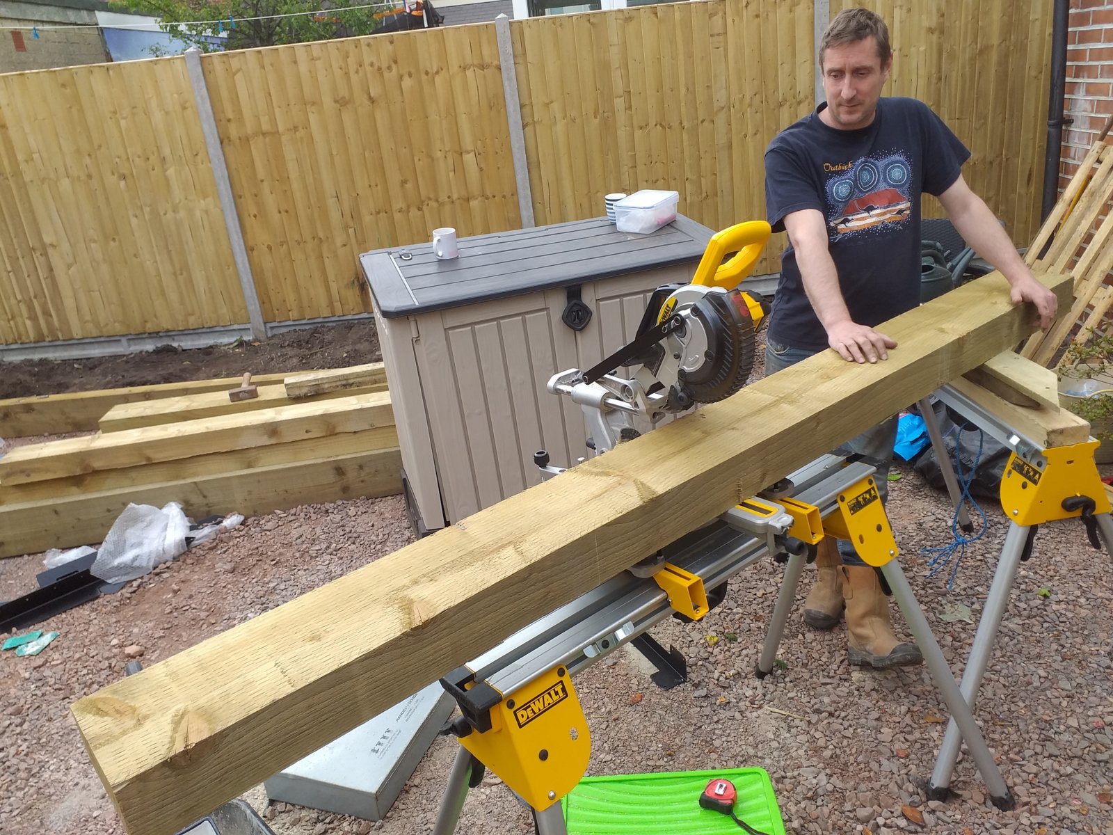

Felt it was too heavy for the arms of mitre saw stand so used another saw horse with wood on it to give more height. Is the mitre saw centred ok. Worried weight of sleeper would bend saws base. And even though have all these washers etc i just used four bolts . Ok?

yes every thing is ok
but you need to support the unsupported timber so when you finish the cut the weight is supported otherwise you will be left with a big heavy bit off timber trying to damage your saw and no hands spare to hold it
you will also find you have about 30mm uncut through the center when flipped with that size off timber
also take your time slow progress on dry timber only or it will close up
if it starts to bind ease off and start again
if it keeps binding dry the wood for a few days and start again
as your saw is rated at 50mm depth off cut dont be surprized if it struggles a bit but should do most off the cut

I was doing multiple cuts of the same size so used the first piece as a template. I turned the wood over and cut both sides then finished the middle off with a hand saw . There were two of us cutting the wood
normally you feed the wood left to right as your right hand is the operating hand and your left hand is the feed in hold tight hand this stops the temptation to cross hands in operation
as an aside the dustbag is badly designed n the down position the sawdust naturally falls out
i bent the wire so in the down position the bag is is fairly level
in the up position the bag goes about half onto the extractor
its also bent slightly to one side to clear the linkage
