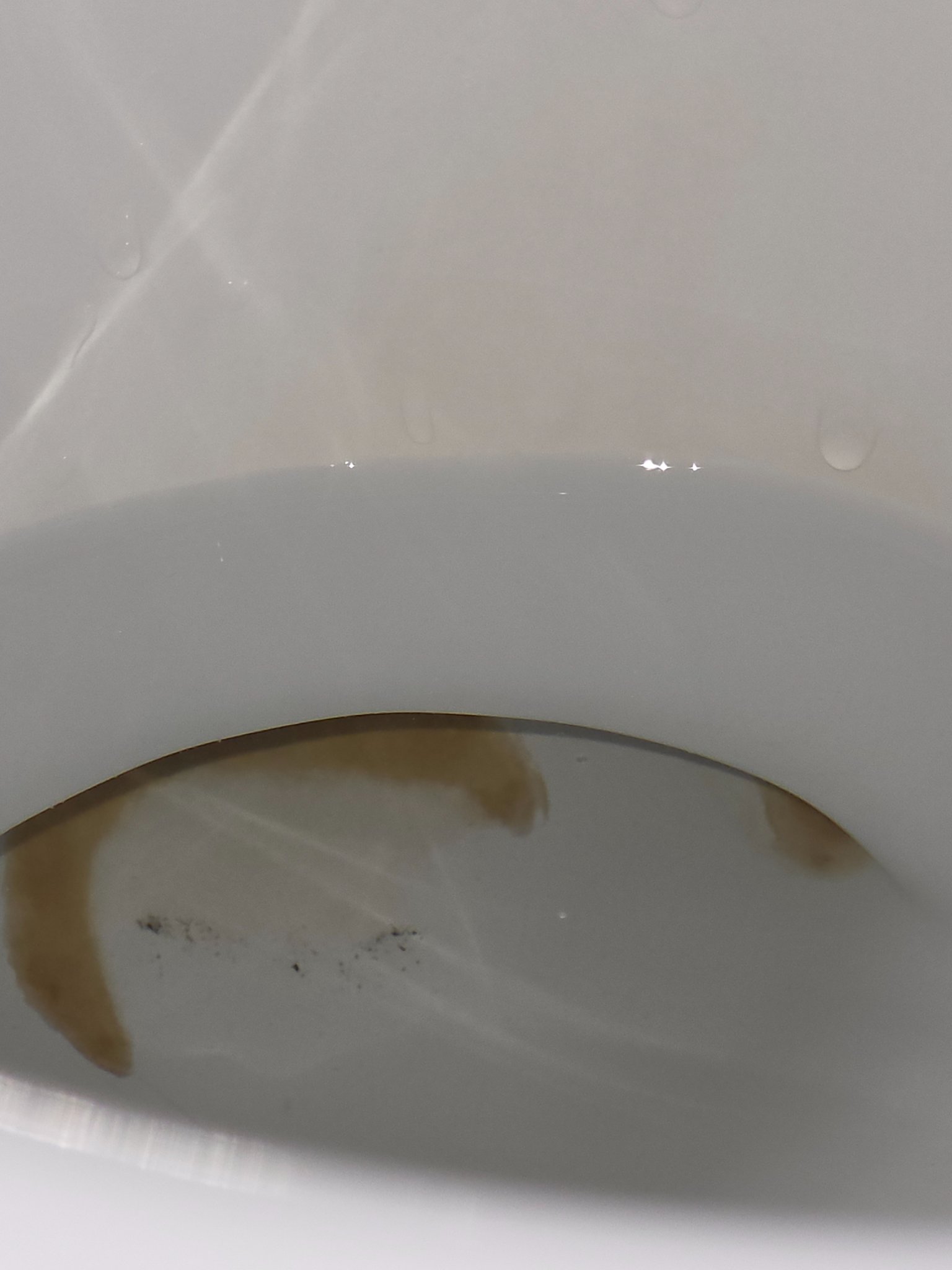

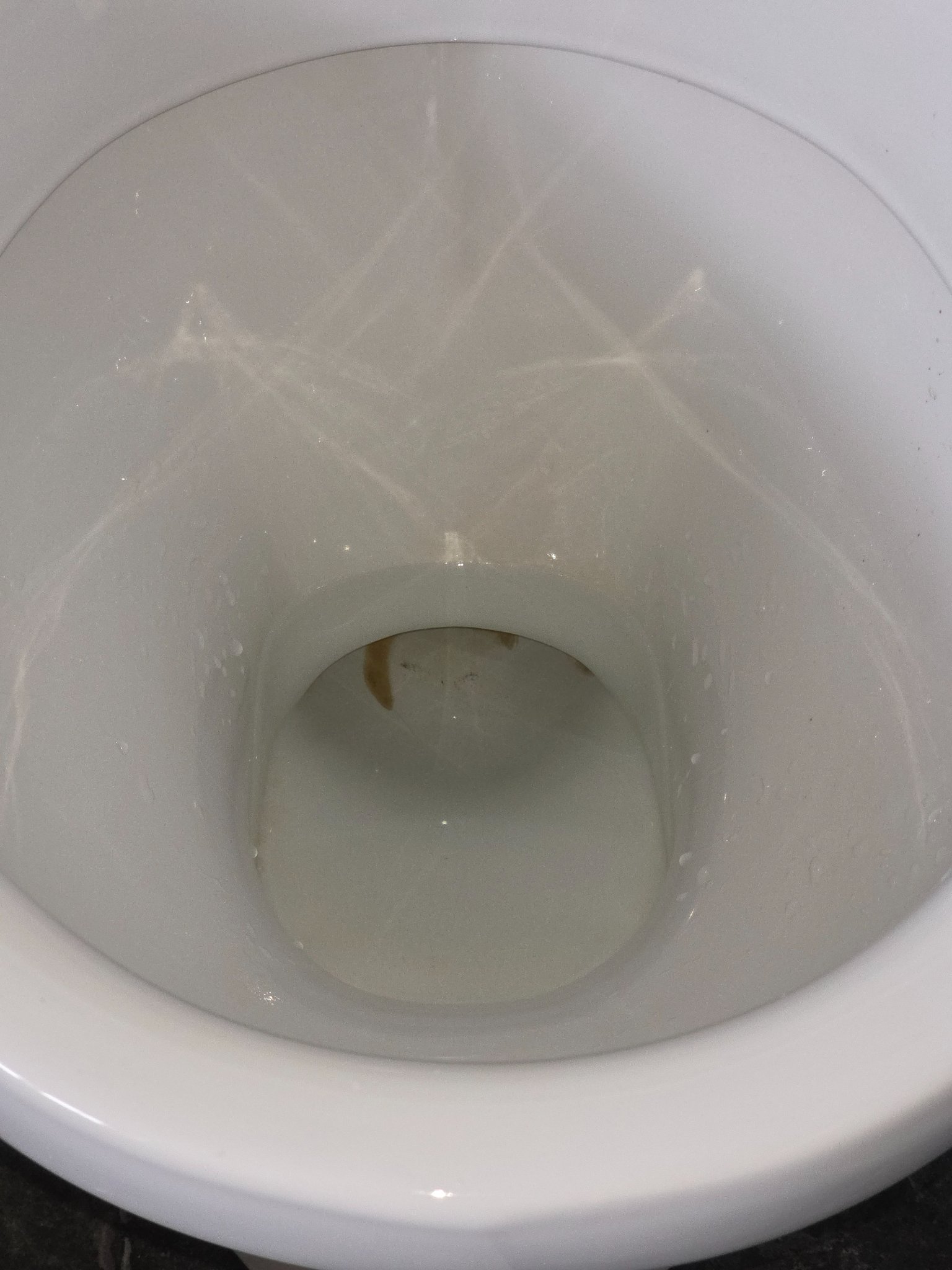

Is my toilet basin erroding or just cosmetic discolouration?
12 Jul 2016
129
Initially I thought this was a slug in my toilet basin! But after trying to remove it I realised that this is a discoloration on the toilet basin itself.
Any idea what has caused this and if it could cause any leaks and/or other issues?
Also how best to remove it? I tried bleach but made no difference.

Lime scale
Going to take a few treatments and several products you can use.
Google it
Use some Harpic 100% Limescale remover for WC's. Give a liberal dosing around the pan and under the rim, it'll run down and cover the entire pan, and mix with the water. Ideally need to leave 24hrs, (Overnight at a minimum), and then gently clean with a suitable Toilet Brush, (protect your eyes/face), and you should find it'll dissolve and leave your Toilet lovely and clean.
Thanks very much for your suggestion.
