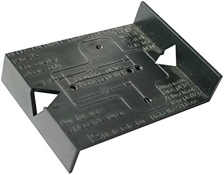

The best way to drill doors is probably just to use a cheapo drill press and electric drill, but fitted with a plywood/MFC baseboard and a back fence. This allows for acvuratevcontrol of the depth (which from memory on Blum hinges is 13mm, other manufacturers are similar), ensures a nice perpendicular drilling and a consistent inset from the edge of the door. But for one offs or only a few doors that may just be overkill, especially as you can mark the centres with a little £3 or £4 jig and an awl (or even a combi square and an awl)

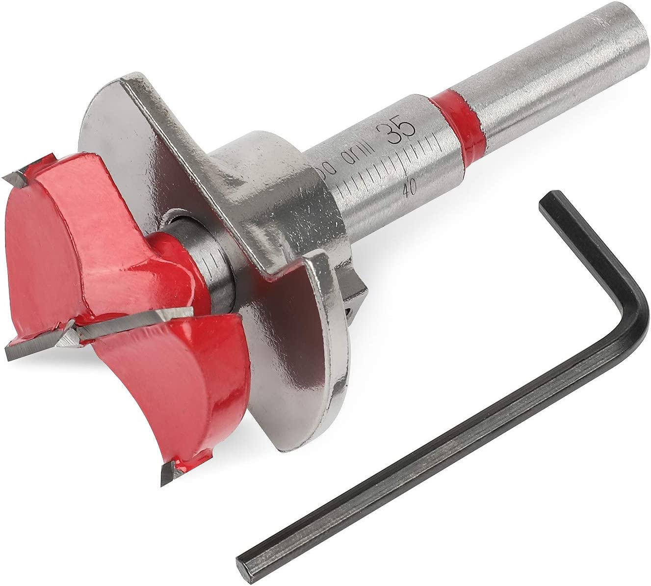

but drilling depth control is important so it may be worth considering one of those 35mm TCT Forstner bits sold on Amazon (for £5 to £7) which are supplied with an integral, adjustable depth stop
I have a set of these in different sizes to deal with lock keeps and they work OK providing you don't press too hard (which can cause the depth stop to move a bit)
BTW the awl (another £2 to £4 purchase) is very useful to mark a centre point in the (potentially) hard, shiny surface of the door before using the Forstner bit - and reduces any tendency to skate across the door when you try to drill it!

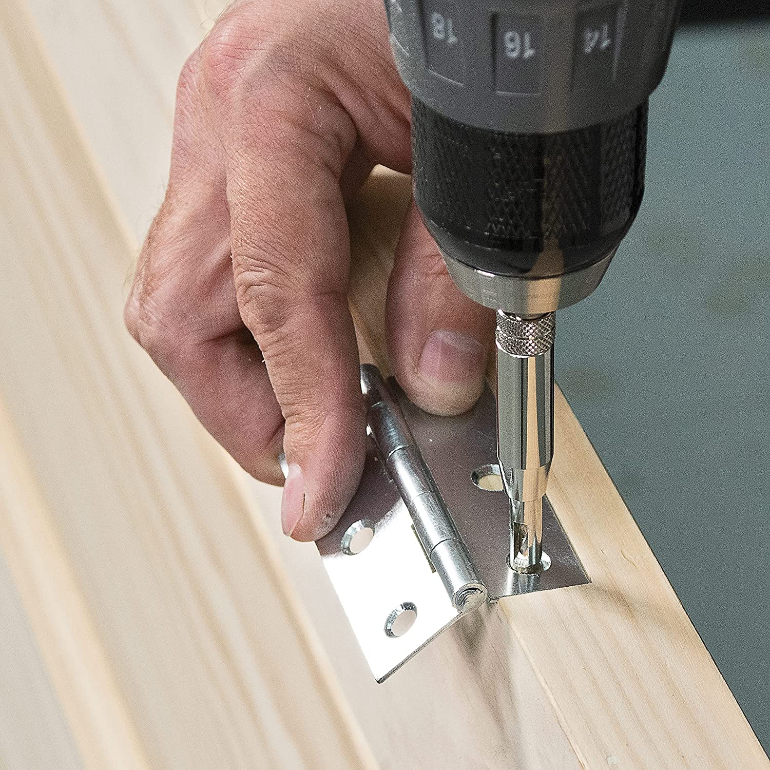

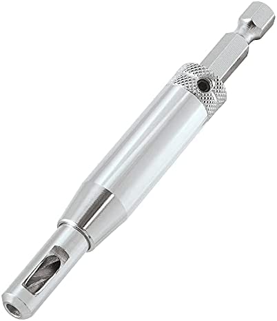

Another potentially useful bit of kit is a Vix bit (a sleeved self-centring drill bit) which can be used to pilot hinge location screw holes once you've lined up the hinge bodies with a straight edge, as mentioned above. I use Trend Snappy ones like this one
but other makes are available. These work be self centring on a hole in a piece of ironmongery and I use different sizes for different hardware installations such as hinges, kick plates, finger platrs, locks, keeps, etc. This is one being used to install a butt hinge
