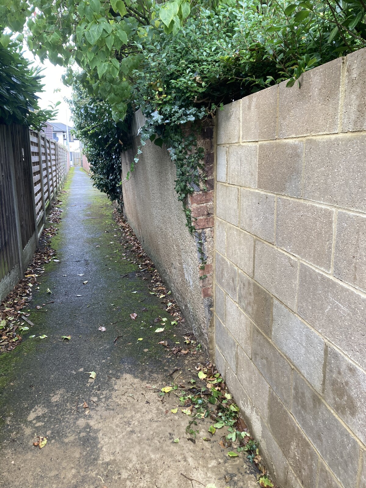

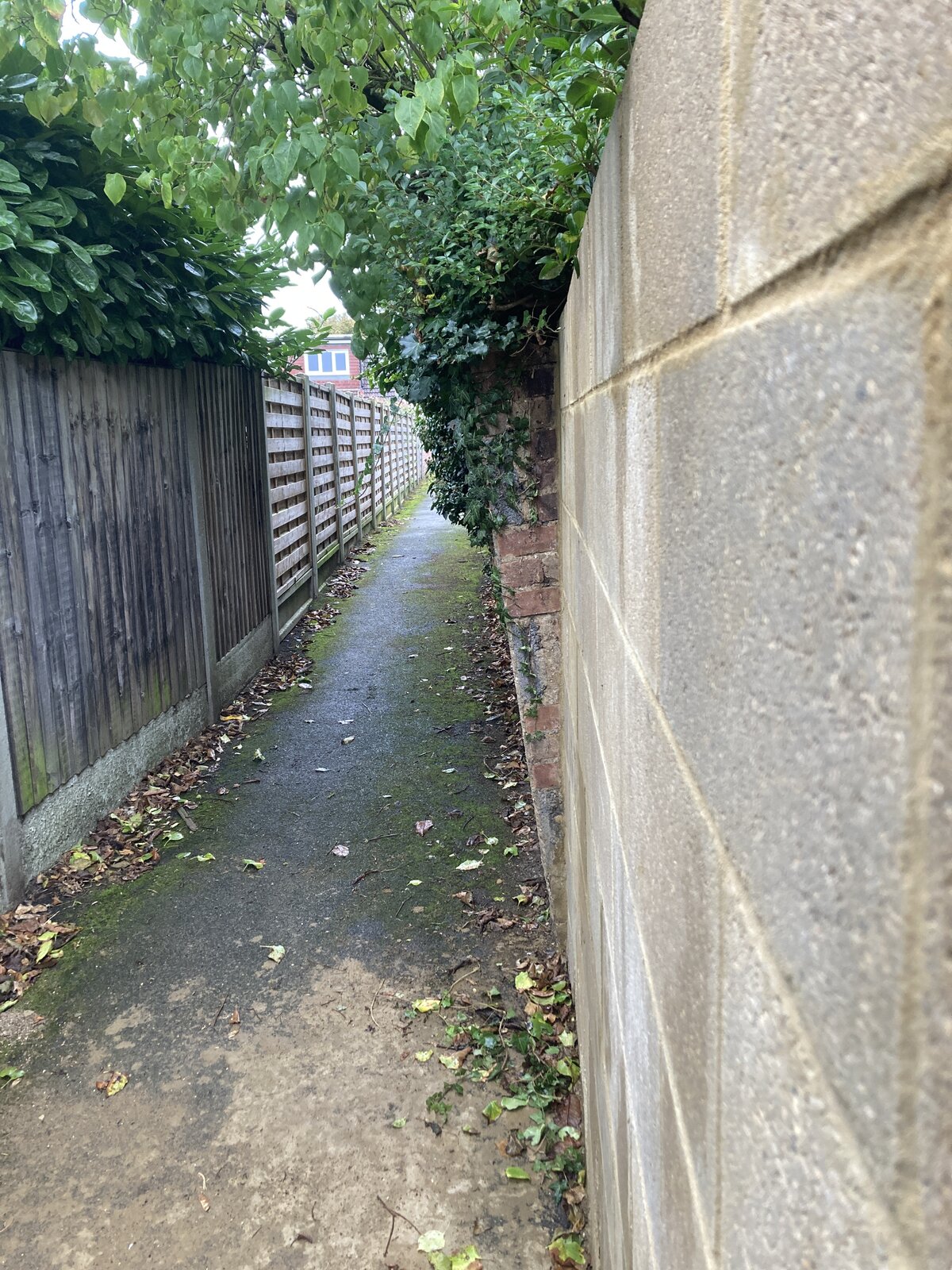

Is the lean on this wall dangerous?
27 Feb 2017
53,617
12,770
Essexshire
Taking my mums dog for a street walk this morning I saw this wall in one of the alleyways I go down. I've been noticing it for years but next door has had their rear garden wall replaced which made it look more noticeable. I'm assuming that the new wall is straight so would you say the other wall has a dangerous lean? I once heard and felt a wall of that size fall down where next doors kids had been playing only moments earlier and the screams from the mum made us go cold. (Fortunately her kids had gone next door). Is it worth reporting to the local authority and if so, which department?
Given that the centre of gravity is outside the footprint of the wall on the ground then the answer has to be Yes it is potentially in danger of toppling over onto the footpath.
It might already be toppling but held in place by the foliage.
If that is a public footpath then the condition of the wall needs reporting to the local council

Yes, report it!
When out walking, I would cross the road to get away from a particular wall, fearing collapse on my dog (..and heaven forbid, if it were to fall on a toddler).
I reported it and within a couple of months it was replaced, along with a few more along the street (and it wasn't nearly as bad as that one!)
it comes under planning and building control / dangerous structures, for my LA.

I've just reported it all online to my local authority building control department and sent pictures. I got an immediate response saying that I can't report dangerous structures online and I have to phone them in the week! I'll do that on Monday.
The Highways department at the council should have a 24/7 emergency phone number, If that is a signposted public footpath then the Highways Department are likely to be responsible for it's upkeep and safety If they are then they may be more proactive than Building Control

Just had a reply.....
Thank you for reporting the wall at the above address.
I carried out an inspection on this wall on 01-11-21. Although the wall is leaning, it is not immediately dangerous and therefore no action was carried out. Should you believe the walls structural state has worsened at any point in the future, please feel free to contact myself or [email protected]

Is there a certain point in degrees as to when a lean on a wall becomes dangerous?

that wall is dangerous no other conclusion can be reached in my opinion
it looks like there are concrete blocks toothed in at right angles so will move the centre off gravity
also iff the foundations are a few inches under the path it will further help by moving the tipping point a bit
buuuuttt we dont know so must assume its about to go and the path needs closing
