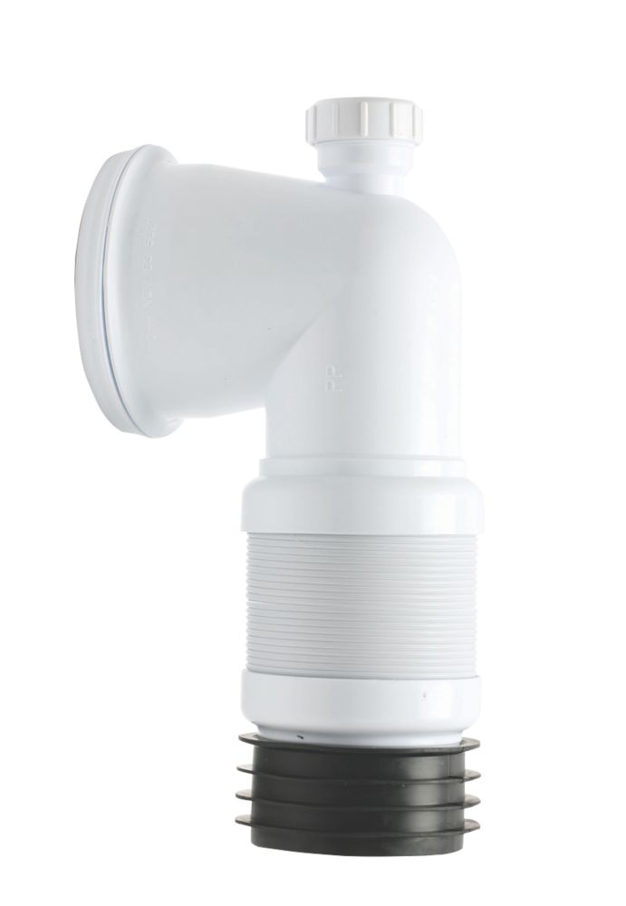

That will connect to the pan spigot, drop down vertically, then make a 90 degree turn just above floor level to join an almost horizontal 110mm pipe off the stack?The pan spigot is 185mm centre above the floor. I've gone boss-eyed searching, can a pro help please. Ta.
You can get the flexible type such as....
although due to the ribbed product and bends may need to be monitored every now and then so blockages don't build up. You can get this version instead which at least give an access for a rodding point....
