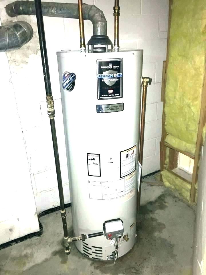

Here is what a standard water heater looked like in Canada when I lived there, and I have not heard of one exploding do to PRV failure. Notice the PRV just dumps on the basement floor, there is no expansion tank or check valve, and the device uses air from the room for combustion. Before I moved to Europe, I had never seen anything else for heating water, except the electric version of the same. They probably make more sophisticated high efficiency ones now, but I bet there are still a lot of these in service.

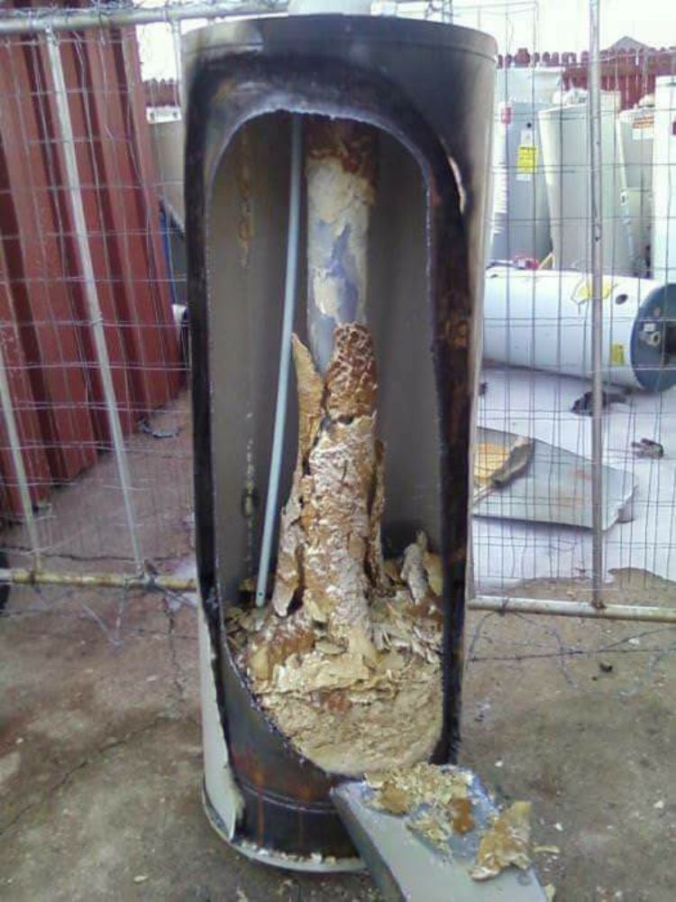

There can be, and almost always is, a great deal of debris in a typical North American water heater.
They run until they rust out, but they don't seem to explode.

But in practice, this does not seem to happen. Even in Canada where all they have is a single PRV, and there is a gas flame directly under the cylinder.
