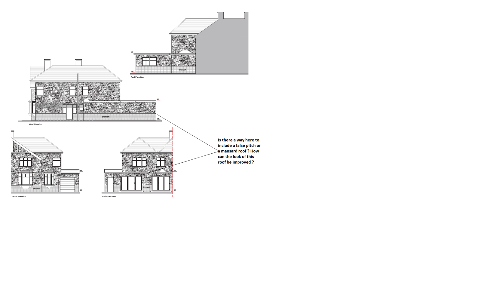

Hi All.
I am putting together a design, and I like to believe there is a way to make this flat roof look better. Any ideas please.
Thanks in advance.
Orangery roof.
They have a fascia with more detail.
You can create classical or contemporary

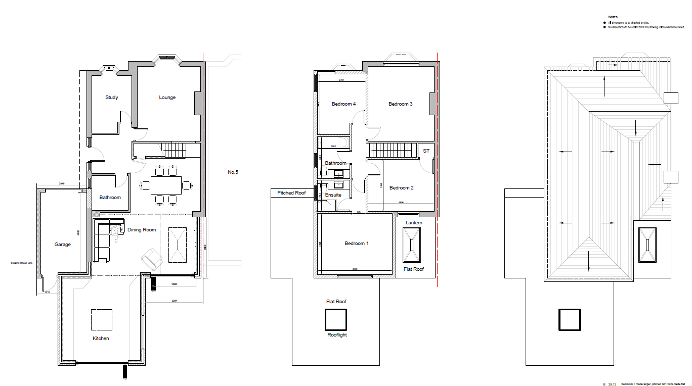

i have a lantern already by one side, are you suggesting another where the kitchen is ? thats going to be huge isnt it, top cover an arae 5m x 5m.
You dont need a lantern, just a flat roof, but finish it with an orangery style fascia rather than a flat conventional fascia board.
FWIW, I'd keep it flat. I think the geometry where it meets the garage, and then returns to meet the main house is too awkward otherwise.
