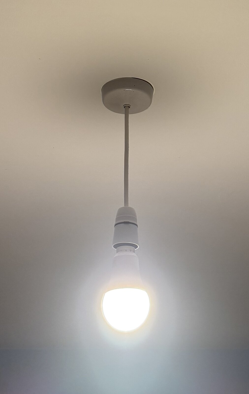

Hello,
I live in a recently built home, the room height is very low, around 230cm, currently the lights are like these in attachment.
I wonder if there is any solution like a ceiling cover to not only hide the LED bulbs, but also to raise the cable that comes out as I touch them often…
In this case I could push it up (but it’s like forcing a brick wall, maybe an electrician needs to cut it…) or I can put the cable around in a circle, but I’m pretty sure that it will create shadow or it will be visible…
Essentially, I want to be able to replace the bulbs by myself, as it’s a very common failure and I can’t pay an electrician multiple times per year…
So, I don’t want ceiling lights with integrated LEDs.

My shed has the same problem, and with tungsten needed some distance to cool, but with LED simply make the lead shorter.

I'm having trouble understanding what you need. Do you want to retain some sort of light in that position, so just change from a pndant to a flush with the ceiling fitting something like this https://www.diynot.com/diy/attachments/flush-png.393366/ or remove the light source completely. In which case just remove the lampholder and cable and leave the ceiling rose in situ. Or something like this https://www.amazon.co.uk/Traditiona...0622935198-B00GGG56YC-&hvexpln=0&gad_source=1
Why do you think you would need to call an electrician when a lamp fails, which wouldn't happen that often.
I had a low ceiling in my vestibule in the last house. I had a surface mount ceiling lamp with two bulbs, I will guess it was really designed as a wall light, but did a good job.

A quick simple way, would be to put a 'pig tail' in the flex drop, fixed with a tiewrap.
I'm not an electrician.
You won't find a 'cover' for the light fitting you have - such a thing doesn't exist - it would be a fire hazard if it did!
As people have suggested, you can either:
-Shorten and reconnect the pendant that you have
-Replace the pendant fitting with a new light fitting that is flush to the ceiling, for example: https://www.argos.co.uk/product/8809423?clickPR=plp:8:126
- Replace the pendant fitting with the kind of fitting Taylortwocities is suggesting
Whichever one if these you go for, once it is installed, you can change the bulb yourself easily
