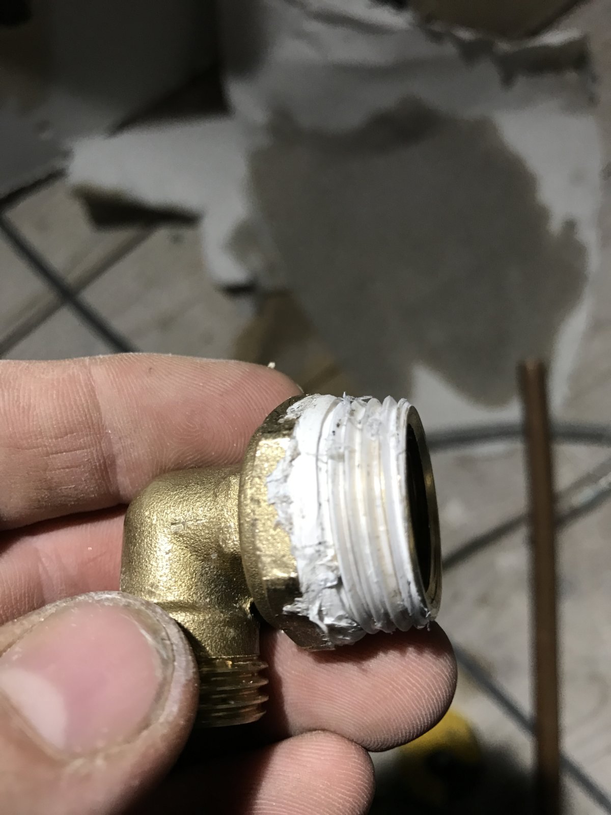

I had a right pain in the arse sealing a 3/4 make thread into a shower. It leaked 3 times. Each time it had a tiny leak that would pass out a single drop of water over 5 days that wasn't heavy enough to fall off the fitting.
I cured it by wrapping the fitting about 25 times which I thought was excessive. It will be behind a plastered wall but I'm a bit paranoid about hiding it even though it isn't leaking now.
Is 25wraps normal, is my PTFE crap or is it just me? Does the PTFE make its seal on the thread or just outside it?
This is it when I took off the last leak

from your photo...is the elbow one fitting or two??...thin line of ptfe looks like it is an elbow going into a reducer??...might be seeing things

No offence meant however is the tape being applied in the correct rotation.
Looking at the last photo of the assembled joint makes me wonder this.
Yes, I wrapped it so the last flap was being pulled into the thread rather than being pushed into it if you know what I mean.

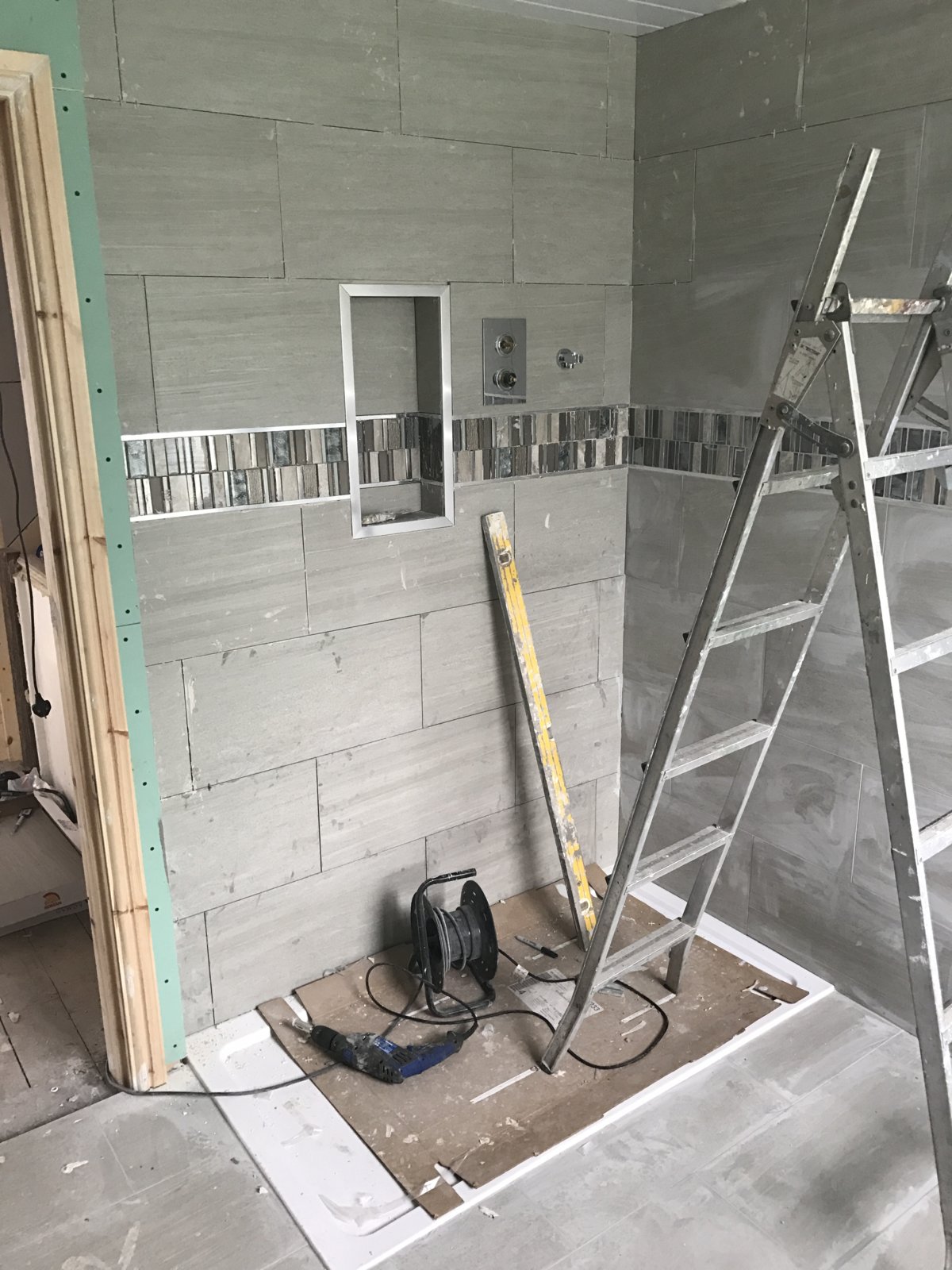

I would have put a straight on but there is a shelf built into the wall just to the side of it.
Don't tell anyone but I forgot that last night and pulled the plasterboard off the back of the tiles :LOL::LOL:
