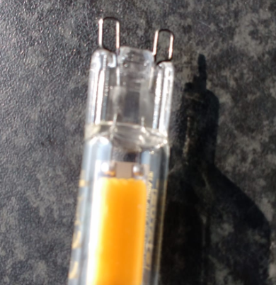

Is this a G9 lamp?
11 Jan 2004
46,670
3,900
It is a 2W LED lamp:
(not my piccy)
Thank you both.
Trying to remotely diagnose an issue with a lamp!
I shall order a 2W G9 and keep my fingers crossed.
G9 lampholders are usually just enough to get a small probe in, if they have a meter they can do a continuity test and if you trust them maybe test voltage at the lampholder
The problem I have found with G9 LED lamps is that they come in varying lengths and not all will fit in all G9 fittings. So best to check.
