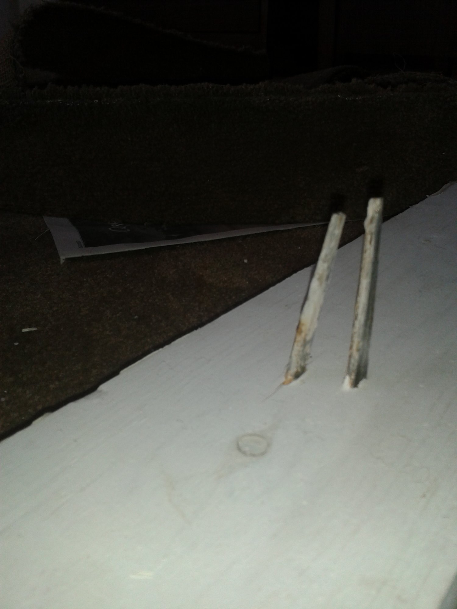

Ive just had a nightmare of a time trying to remove two bits of skirting board from a plasterboard wall.
They were fastened with massive floor board nails.
After much swearing I got them off in the end but with one of the skirts i had to resort to sliding a hacksaw blade behind the wall and cutting the majority of the nails to avoid doing too much damage to the wall with the pry bar i was using.
Any way the question i wanted to ask, is it normal practice to fasten skirting with these things?
It seems like over kill and whoever did it didn't want the skirts to be removed with out taking half the wall with them!
Ill just be refitting them with a nail gun an maybe some grab adhesive
Yes it's normal to use them. And normal for half the wall to come off if you try to lever them out.
They are cut nails - some chippies love them, loads still used but not for flooring for a few decades now.

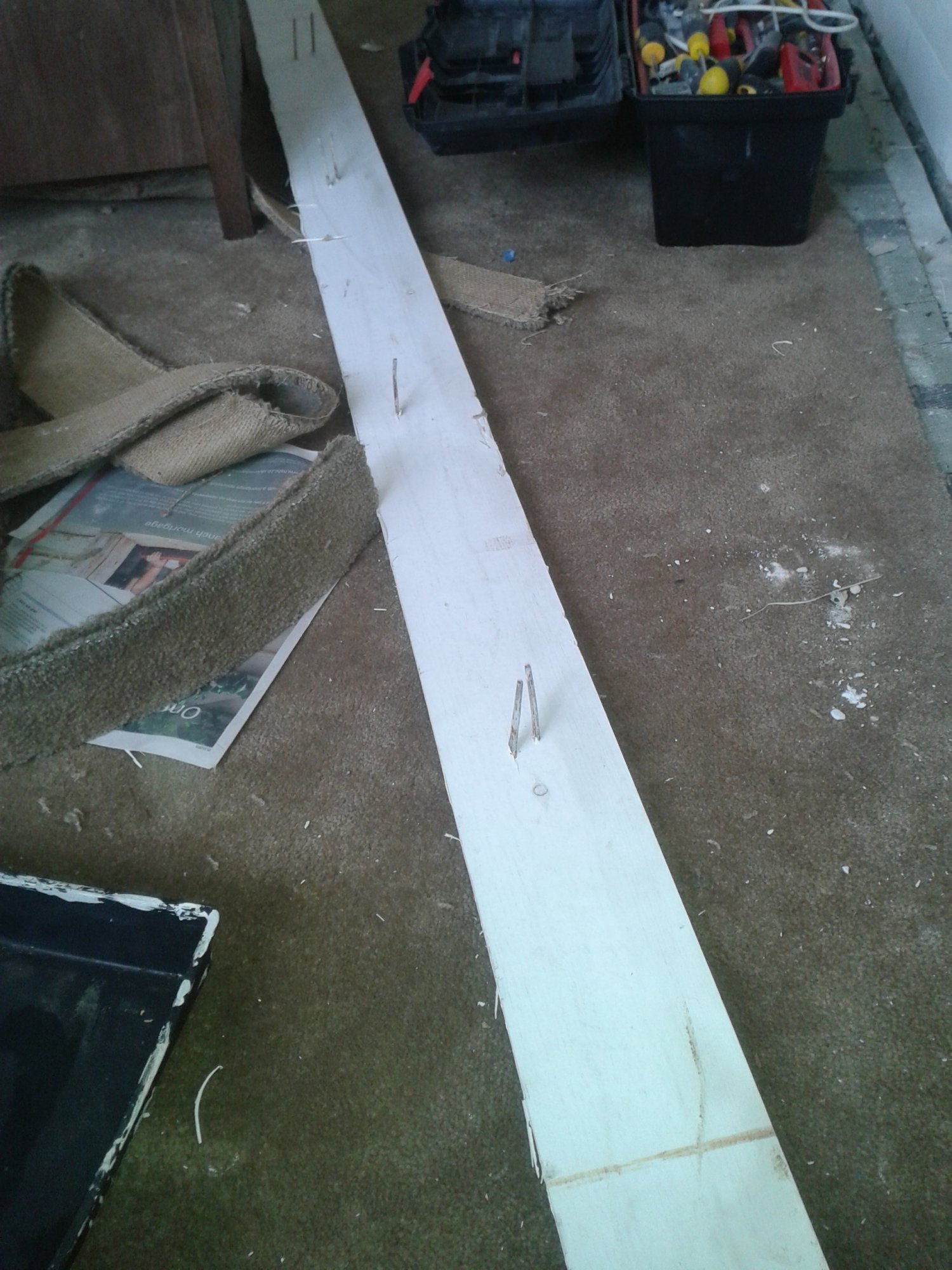

Is there any other way of removing them as opposed to levering them out?
I reckon ill have to do this again when i start working on other rooms
I thought the OP's problem was getting the nails out of the wall not the skirting.
It's often best to lever the skirting so the nails pop through and stay in the wall, and then deal with those - by hammering them over.
If they were just in the wall he could lever them out. Never hammer over nails if you have the option of removing them completely.
If the nails are stuck in the wall, you can fatigue them by hammering them from side to side until they snap.
