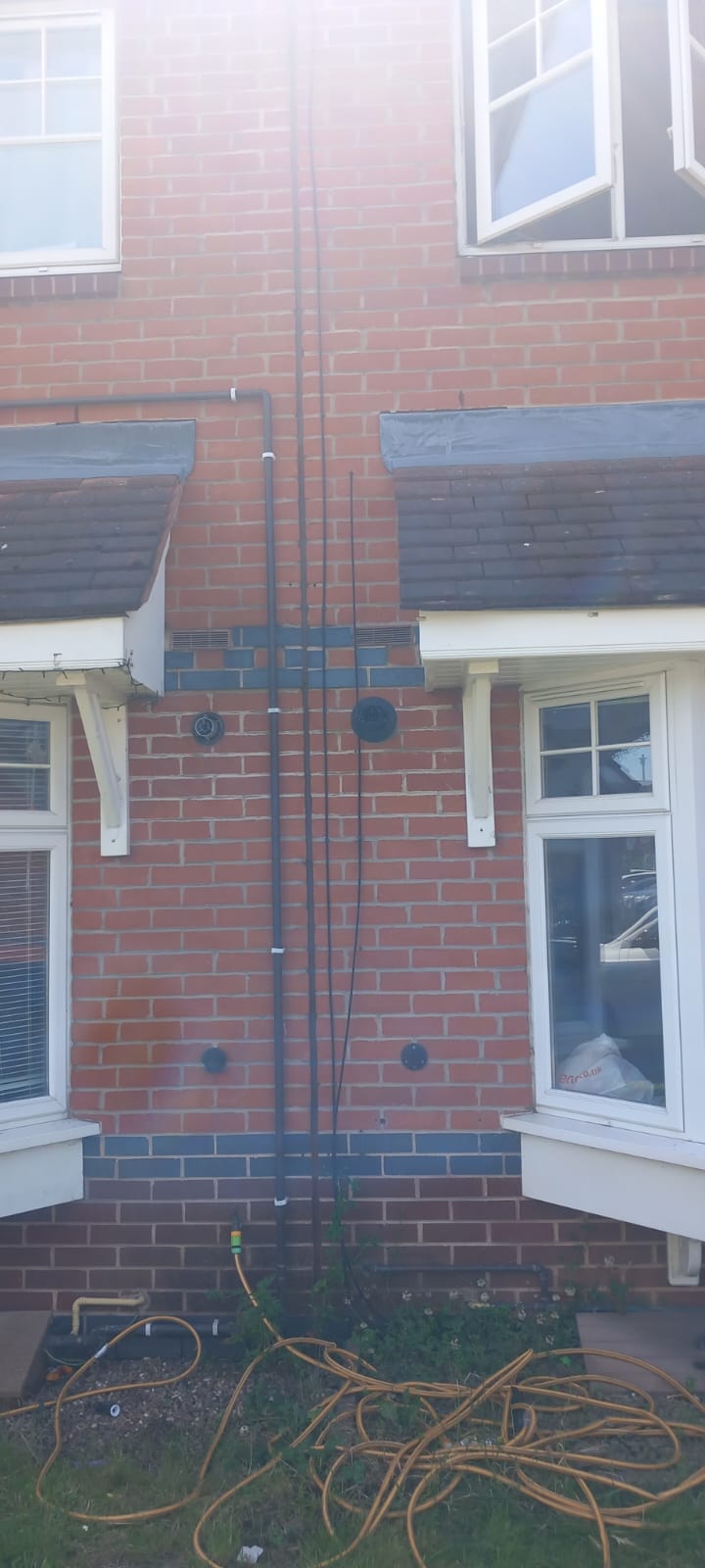

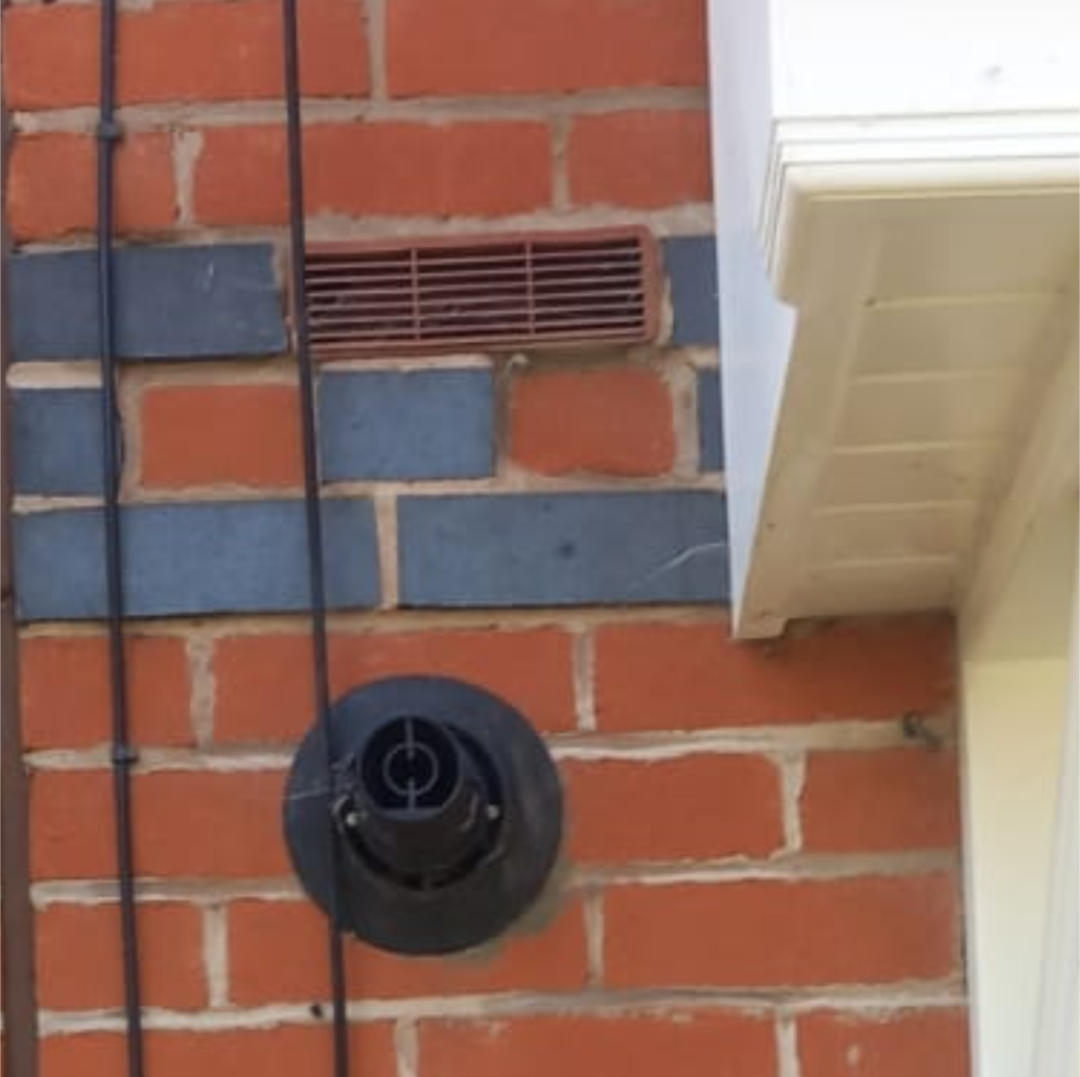

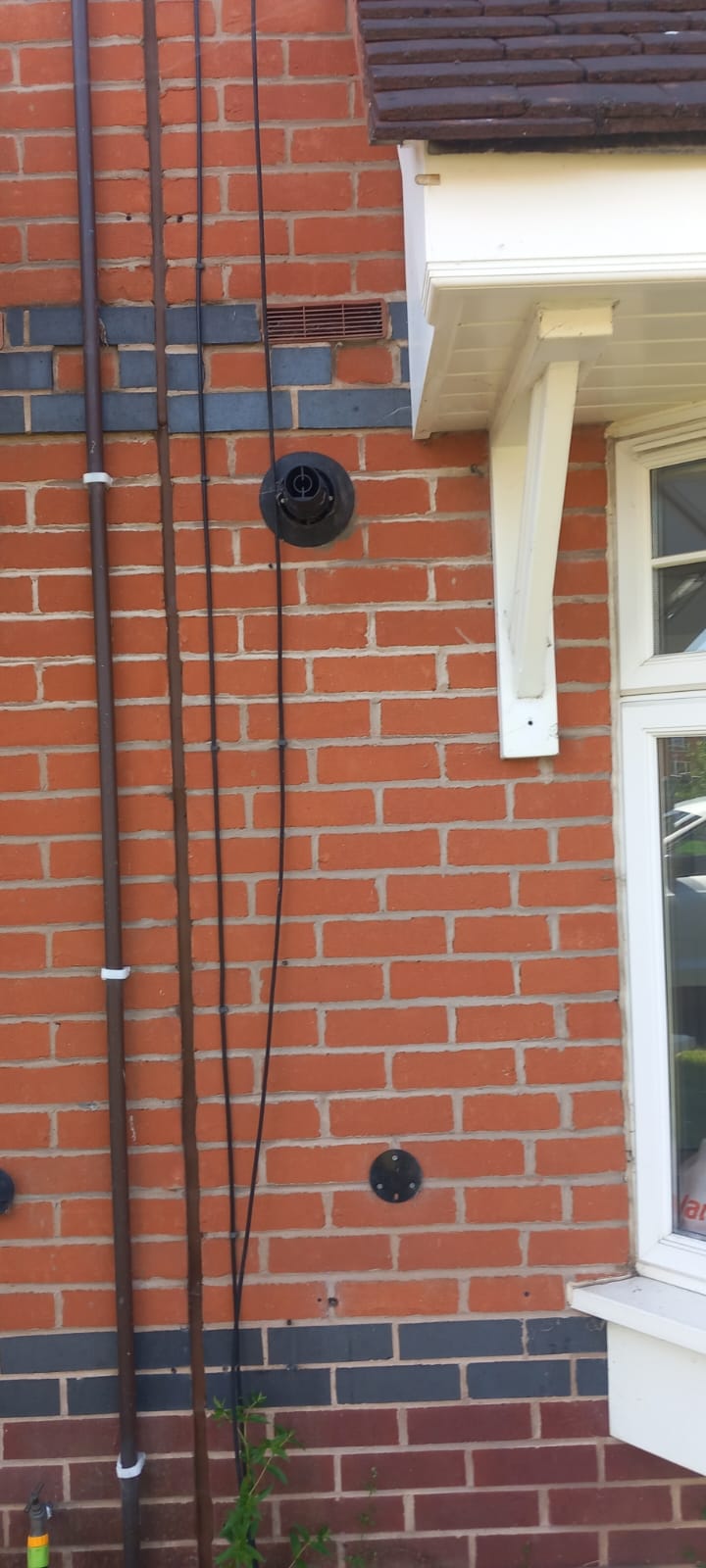

Hi,
Current building regulations state that an opening on an external cannot be with 30cm of a boiler flue.
In this property, all the properties seem to have an air brick (at least I think that's what it is), above and within 30cm of the boiler flue. I looked up and down the street and all the houses have the same.
I have attached pictures.
1. Is this an air brick? If not what is its function?
Yeah.
You are correct.
It happens.
It shouldn't.
I have similar and it's just marked as not to regulations on the boiler service paperwork.
It could be a vent for a cooker hood.
I have one just like that.
Or is that effectively the same thing in terms of a flue?
Could it be a cavity tray weep hole brick, there appears to be exception to the 300 mm rule if fire resistant materials are used
