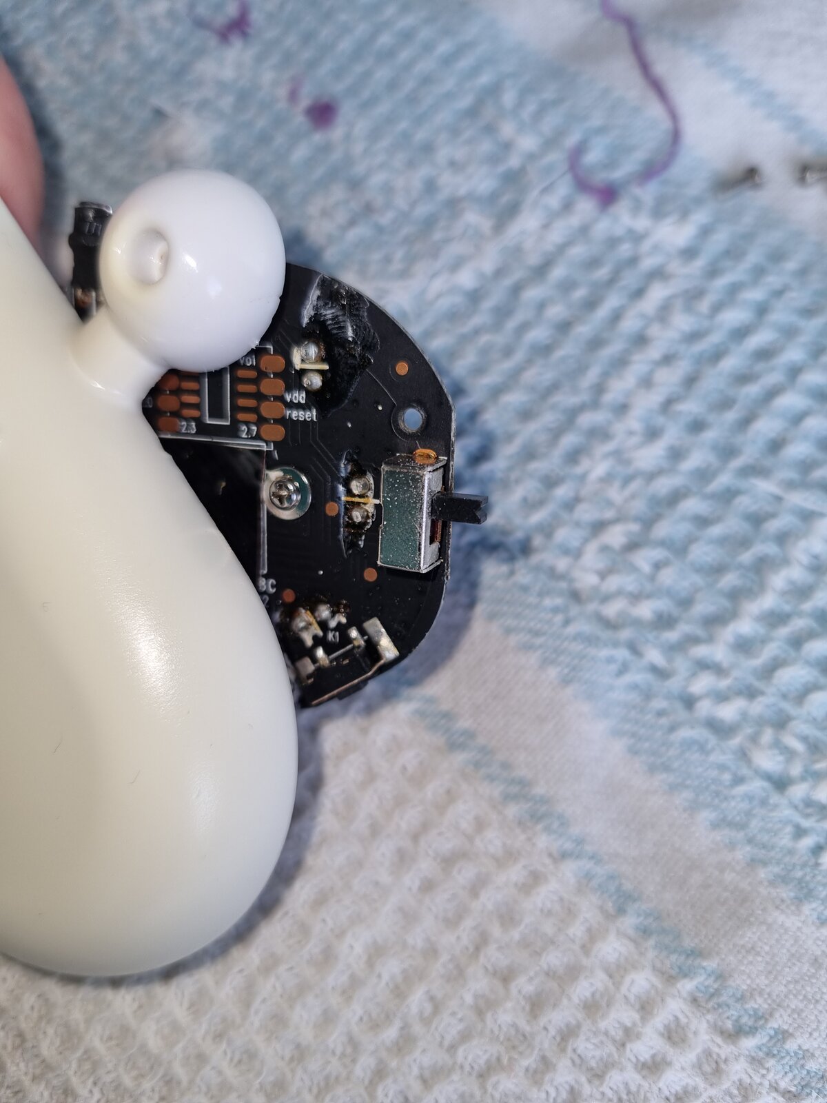

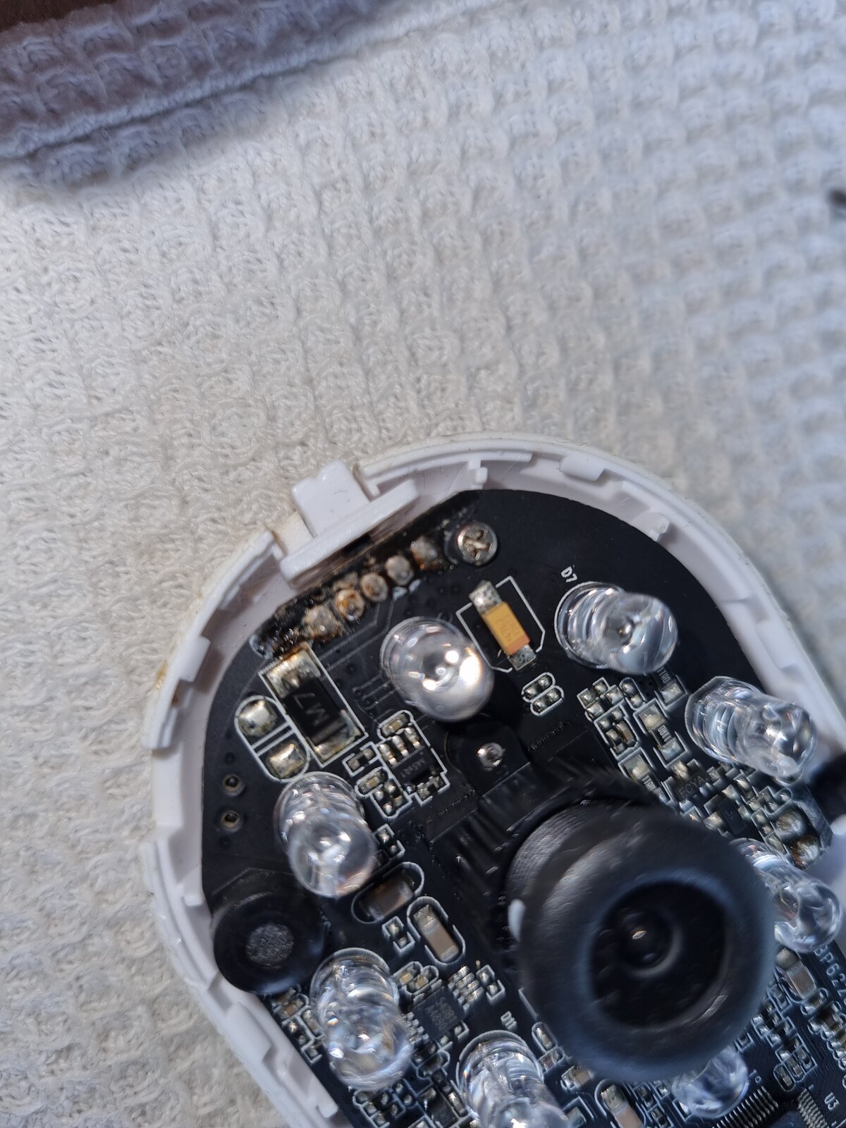

Hi, could anyone possibly help me, the switch on the camera unit of my baby monitor randomly works when I try to switch it on using the switch at the side of the unit. Even when it's on it switches on and off randomly. I've noticed when it does this the unit has a squealing sound coming from it. Is this ready for the bin do you think? Thanks in advance.

Those connector pins are corroded, they need cleaning and resoldering.
That may cure the problem.
