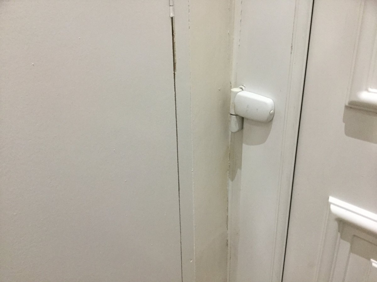

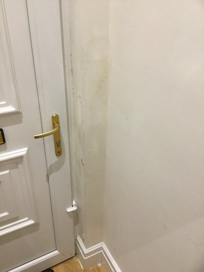

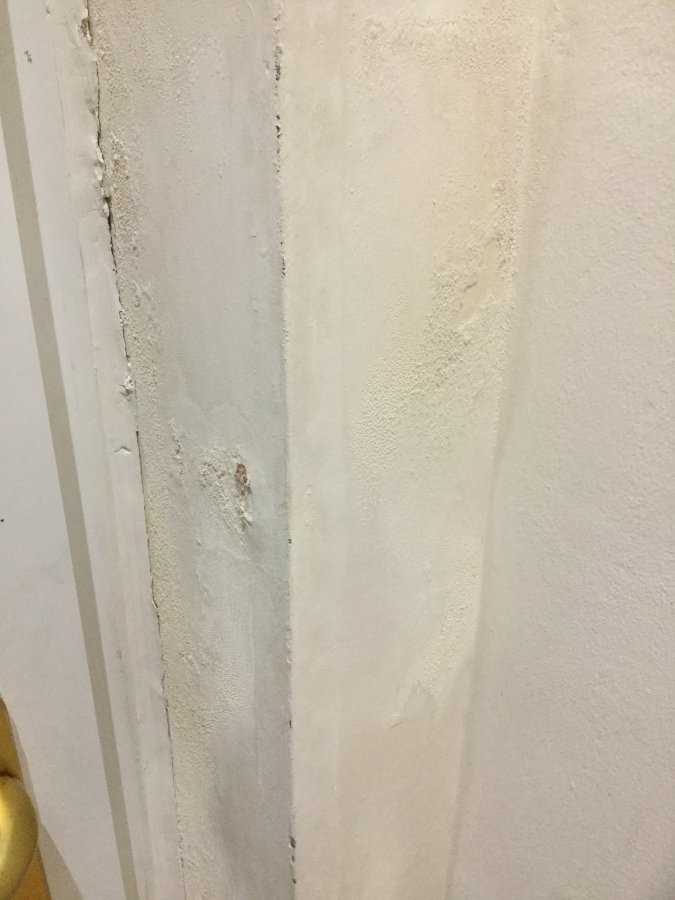

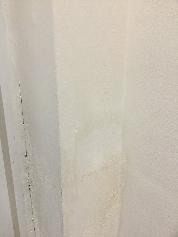

So as it says is this damp around my front door. It is only on the one side of the door and seems to be solid. The front was repointed and painted over with masonry paint in April and this seems to have got worse. As the pictures show it's only half way up and just on the corner doesn't seem to travel along the wall.
Any help on how to rectify it would be a appreciated thanks.

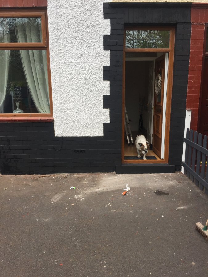

Looks strange, why not post an outside picture of the door and one of the good side. I am trying to understand how that return has been built so looking for clues! Any history would be welcome such as was it once an outside lobby and a door added further out to gain indoor space.
The first picture is of the other wall. The second of the doorway after pointing and painting. The door has always been there as exactly the same as every other house on the street. When I repointed it there wasn't really any mortar left in the joints. It had been fixed with the red clay like stuff and suffered badly with the white salts coming through hence the repointing.
Just to add the black bit looks wet in some places as this was taken straight after painting.

What's that ledge above the door? Getting worse after painting and repointing suggests it can't evaporate as much now, but it's still getting in. It's more likely to be penetrating damp around the reveal than rising from below. If it has got worse in summer then condensation is unlikely.
I'm wondering whether it's running in around that ledge and then running down somewhere.
The ledge is just like a little rain cover I think comes out about 3 inches or so don't think it does much. The water does run down the wall a bit as then guttering is sort of sat on top of the wall in a square box shape guttering. But would it be doing it higher instead of just down at the bottom.
The white salts suggest wetness in the bricks as the salts get left behind as it evaporates. So I am inclined to go along with JD. Suspect water coming down that wall where the bricks key in with the render. That joint is weak point for water getting in. I don't generally agree with putting anything on bricks as they cannot "breath" out moisture if it gets into the outer leaf, the same goes for the mortar. You may have stopped salts forming but have trapped the moisture that contained them. Now you have to find the real source of the problem (water). Start at the top with the roof and guttering and work down.
Do all similar neighbouring houses have the same render & Tyrolean finish?
As suggested above, the black paint is doing you no favours.
Perhaps both the white & the black paints are oil based plastic paints - they look too shiny for masonry wash. But maybe thats just my view?

FWIW: the broken window sill tile is allowing water to run back to the wall.
Yeah all the houses on the row look the same the paint is masonry paint for use on bricks looks a lot duller now it's dry.
It's a cavity wall with the small grey ball insulation fitted before I bought the house.
