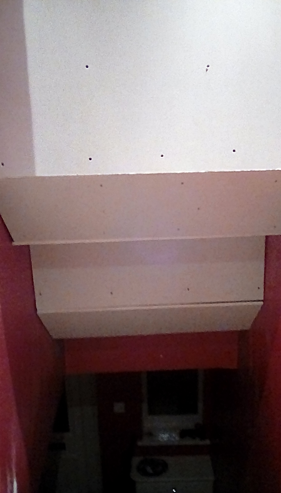

Hi guys.
As my son is in the box room I've removed the built in cupboard for more space and now I've knocked through into the stairwell to create his wardrobe. I've framed it out and plasterboarded it. Will it be pretty straightforward to skim over. I'm thinking of a multi finish plaster and would like any help and advice. I know it's late but I'll hopefully be trying this in the morning so would appreciate all constructive advice.

You would have done better to have battened the underside of the stairs, and taken the plasterboard right the way down in one piece. Then you'd have followed Alastairs instructions, although some people will tell you to add the water onto your trowel so that you don't overwet the plaster, but it's whatever works best for you.
This is above the stairs pal. And my lad is getting big. I'm 6' and he's taller than me so had to make it with headroom when coming down stairs.
But you've got 2 sloping sections, with a flat and vertical in between, so by definition, you should have been able to take the slope down the whole section. But it may be the perspective that I'm looking at it from. It doen's matter that you didn't, and it shouldn't affect how the two of you get down the stairs. I had a similar setup in my last place, and it's an interesting trick, so well worth doing.
I tried framing it both ways and this "felt" like the better option when walking down. It just seemed to give more headroom.

It's all just a learning curve jc; give it a couple of years, and you'll be on here giving out the advice from what you've learned from this. The way you've done it isn't wrong by any means, and oddly enough, may well be easier for a beginner having smaller sections to work on at a time. If you'd sloped the whole section, you'd have had a more standard layout, but a larger section to work on. But Hearts is right when he points out that it should be double plaster board for the fire regs, or a single skin of fire rated board.

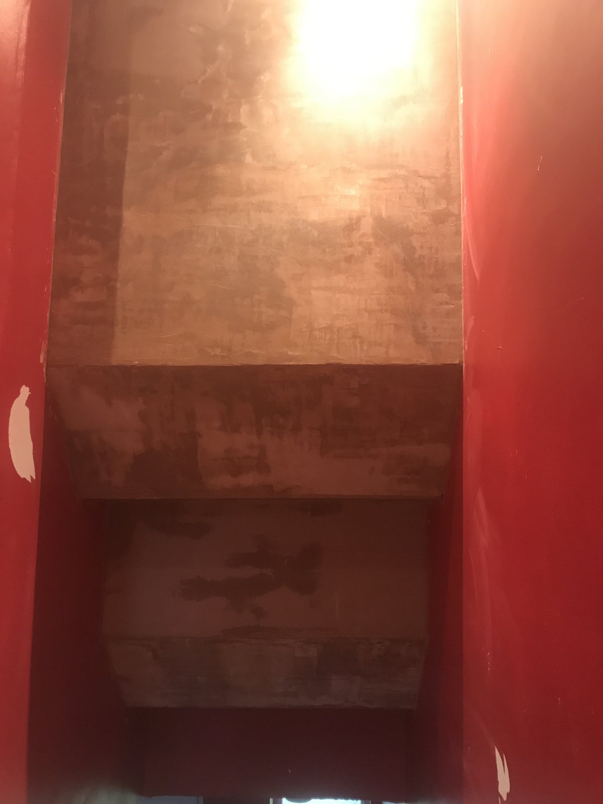

Well guys all done. Hope it meets your approval. Thanks for all the advice. Doesn't look too bad. But I'm always over critical of myself.
Thanks again guys.
