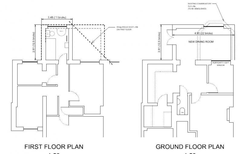

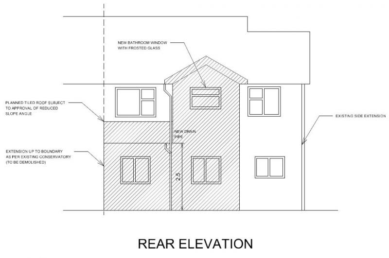

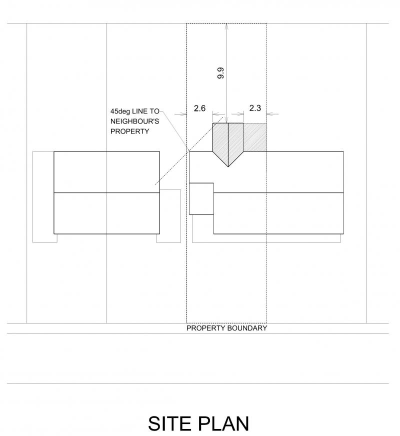

We're having a conservatory replaced with an extension this year, and wish to build a first floor extension as part of the plans.
I've had a good look at the planning portal site, regards permitted development, however the council will not answer my "do I need planning permission?" question without relieving me of £86 first.
Can anyone please offer advice? I've attached the plans below. Many thanks.
Looks good to me provided you're not in an AONB or Conservation Area or other oddity. And your property has all of its PD rights intact of course.
Thanks FMT, I'm presently trying to confirm the other aspect of building here, which is the covenants on the estate to obtain permission from the council due to it being ex-council. To be honest I don't think anyone else has ever asked (and it includes sheds etc.) but I need it confirmed for peace of mind.
The main reason I ask, and what threw my confidence a bit, was reading the following on the planning portal website (this document):
Someone at the government said:

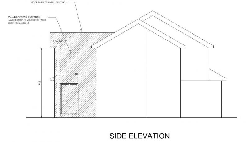

(g) the enlarged part of the dwellinghouse would be within 2 metres of the boundary of the curtilage of the dwellinghouse, and the height of the eaves of the enlarged part would exceed 3 metres.
Where any part of a proposed extension to a house is within two metres of the boundary of the land surrounding the property, then the maximum height of the eaves that is allowed for all parts of the proposal is three metres.
I read that to mean that if I build a one storey extension the full width, I'd be within PD. Also if I build a two storey extension in the middle, I'd be within PD. But building both at the same time, I wouldn't. It didn't seem to make sense, but is that your experience of the interpretation?
Unfortunately you are correct in your interpretation.
Although the eaves of the two-storey part are further than 2m from the boundary, the whole extension is caught. That design would need planning permission.

I'll proceed with the application and keep it honest with the neighbours. I believe the design to be within the council's guidelines, hence the 45 degree lines to the windows: they talk mainly of front-facing extensions but even so an extension last year was completed outside these guidelines with an application taking a not-unreasonable time.
